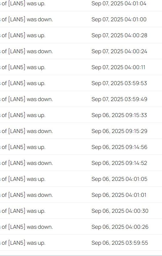

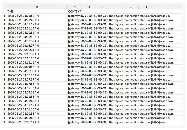

    Any Ideas why

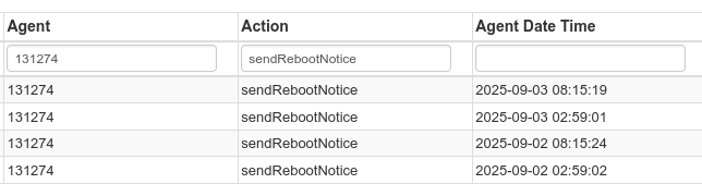

            • SBKS Offline
              This is what I see and time is in UTC

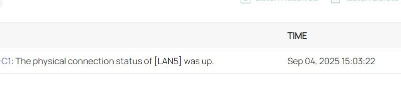

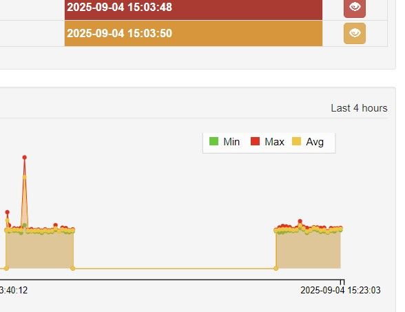

              • E Offline
                E Offline
                Hi Ed,
                I plugged the box in at 15:03 London, UK time, GMT, and both interfaces agree with this time.

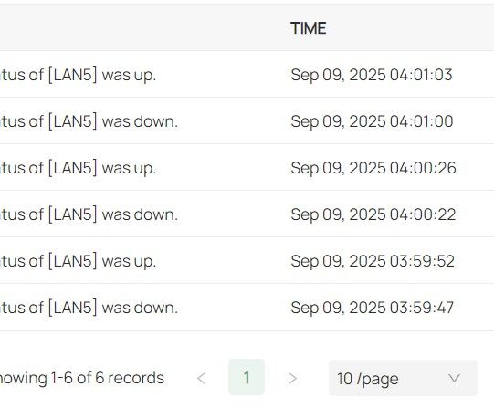

                                • E Offline
                                  E Offline
                                  Hi Ed,
                                  Thanks, I am only getting one reboot around 4 am
