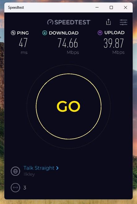

                    Hi there, I am experiencing lower Internet speeds on the display than in all my apps. Most of the time, I get 70mg download and 30mg upload speeds, but my display does not reflect that. Would you recommend an app or website to compare speeds? Thanks.
                    https://www.speedtest.net/my-result/d/501893f9-8943-43c5-a1e9-de2a251a9257
                    Speed.jpg Today at 12:25 pm
                      wrote last edited by
                      Can you start a new post next time please so that we can help. When different topics are mixed into one post, it's harder for us to keep track to help.
                      Commercial speed testing is something most people don't usually fully understand.
                      When you use those commercial speed test services, they are highly optimized and on the edge of the ISP network, called CDN's (Content delivery networks).
                      You'll almost always get the very best speeds possible when using those. Those are only useful when you have severe speed issues and they can help confirm.
                      They are also highly optimized because they are using your browser. Browse based tests will always be faster than real world testing.
                      Our test is more 'real world' in that it measures from source (your location) to destination (one of our locations) over the Internet rather than to an optimized local network. Our tests do not use browsers but raw TCP so the speed will always seem lower but it's the actual speed reached from one point to another over the Internet.
                      When you connect to anything over the Internet, you're going over many networks that may or may not limit throughput. Almost all networks will never allow you to use all of their bandwidth so have some sort of limiting controls that automatically slowly throttle speeds down so that there is plenty of bandwidth for others as well.
                      This is something you'll usually never notice when using a browser but it's very noticeable when you're downloading large files for example.
                      It's just how the Internet works, it's shared.
                      Hope this helps.
