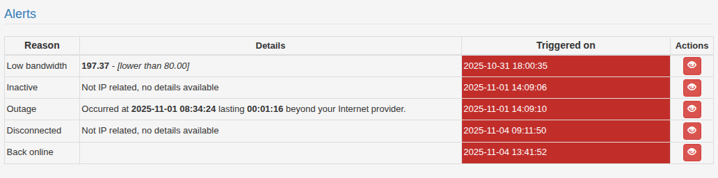

          Looking at your agent, the dashboard does show disconnections;
          Inactive Not IP related, no details available
          Disconnected Not IP related, no details available
          There are no details for these because they aren't IP outages, just disconnections.
          That said, there are only four disconnections total. Disconnections are status 'Inactive' and 'Disconnected' IF you don't see IP outages for the same time.
          Does this help to better understand what you're seeing and how to control those emails?

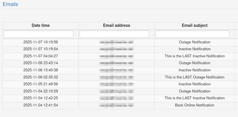

            Thanks for your response, and yes I am aware that emails stop to prevent spam after 3 emails, but I am getting only 1 email and gets toggle off, So thats not the eway it shold work no?
            Regarding when Internet was down and the agent couldnt connect I see the following:
            2025-11-07 11:18:40 - Down (157.238.227.205) for 1m 15s (Beyond)
            2025-11-07 05:04:01 - Down (201.154.156.173) for 26s (Provider)
            2025-11-07 05:03:40 - Down (201.154.156.173) for 10s (Provider)
            2025-11-07 04:56:49 - Down (165.254.191.97) for 16s (Beyond)
            2025-11-07 04:56:14 - Down (201.154.156.173) for 13s (Provider)
            2025-11-07 00:43:00 - Down (201.154.156.173) for 11s (Provider)
            So it was down seconds, and only received 1 email at 5:05 AM when email gets toggle off, what about the previous disconections without any notifications, why email was toggle off when the 5:04:01 disconection only lasted 26 seconds?
            At 11:18:40 has been down for 1m 15 sec and received the email just now

                  Before diving into this can you please confirm that these are the emails you received in the last 4 days?
                  • I Offline
                    I Offline
                    Icarus67
                    Yes, those are
                    • SBKS Offline
                      So I think I understand where the misunderstanding comes from...
                      We reset every 3 emails to avoid having problem with email spamming: some sites are TOO sensitive to a massive sending of emails to the same address.
                      I realize that the problem is in the subject of the email, like for instance "This is the LAST Inactive Notification", where one can interpret it as the last of other two "inactive notifications" and not the last because other two (not necessary inactive) were sent.
                      I think we should improve it...

                                    Icarus67
                                    I understand but the count of 3 is restarted every day or is cumulative?
                                    • SBKS Offline
                                      As soon as you receive the 3rd email the system disables the notifications and you are "obliged" to login, go to the notification tab of the dashboard and enable it again.
                                        And to remind why the logic is this way, it's because if the service blasts emails to many users on the same mail service, there is as good chance our mail services get blocked and then no one receives their notifications.
                                        However, when using SMS (texting), we have no such limitations at this time.
