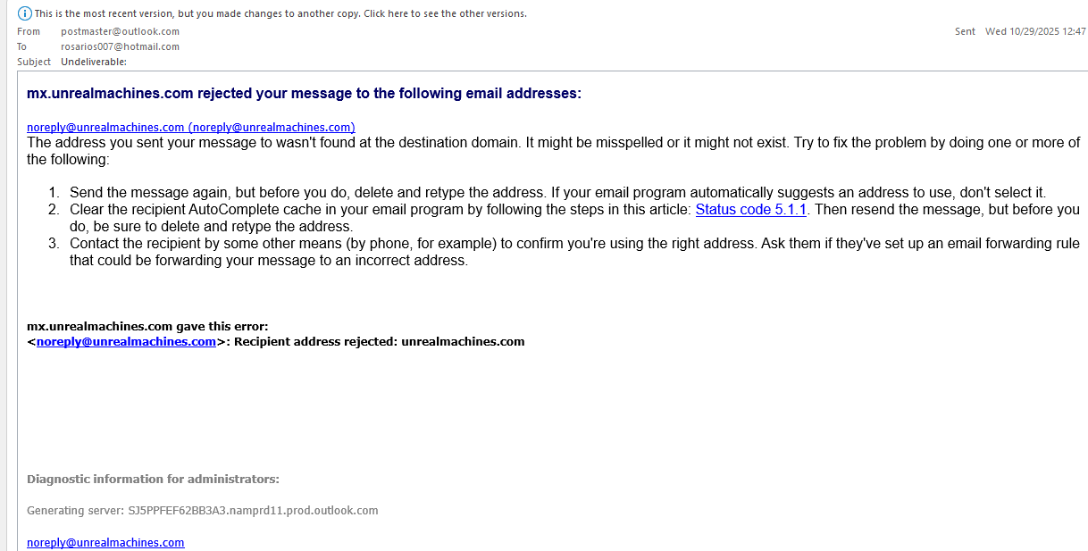

        @ISPtracker_Support should I sent empty emails to those 2 addreses?
        • I Offline
          I Offline
          Icarus67
            That's fine, The error is normal, the point is that your mail service should now see that you want emails from these domains.

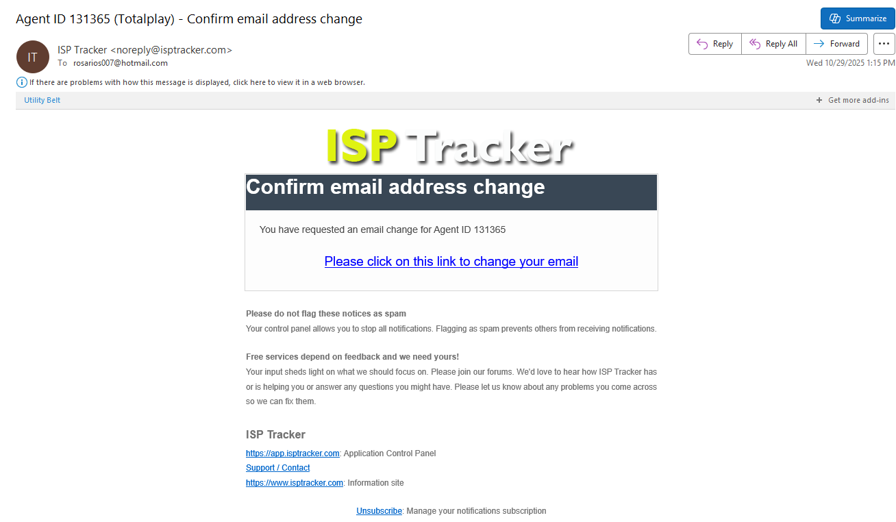

                It was working fine when I was using the software agent, since I activated the hardware one it stoped working
                  Can you try the test I suggested, changing the email address to see if you get the email. Maybe try another mail service to confirm hotmail is blocking the email which I suspect is what is happening.
                  • I Offline
                    I Offline
                    Icarus67
                    Done
                      Nice, that worked then. I would remove the image since it has your personal email showing publicly but seems it's ok now.
                      Hotmail is likely blocking some of our emails which means the more you flag 'not spam' or send noreply messages, the sooner hotmail will send correctly again.
