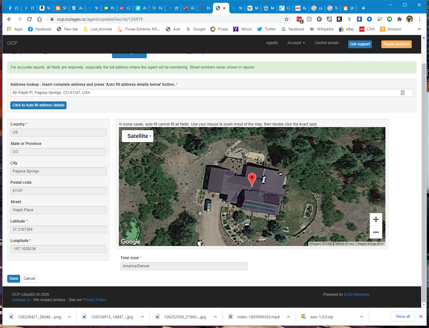

    I'm trying to enter the address/map coordinates/etc.
    It doesn't do an auto fill – the map just says no satellite data at this location.
    Linda

      lklawrie
      Finally got it set up by laboriously moving the map to our approximate address.
      Linda
        Yes, in some cases, auto fill cannot find the exact address which is why we make the map available to zoom in/out, positioning as needed then double clicking to set the location.
        We also re-designed it a few days ago to make it more intuitive after getting some feedback. Hope you found it easy to use and understand.

              lklawrie
              Here's what my configure geo location screen looks like (if it will let me upload)
              Even when it got to approximately my location (after moving the map from 0,0), I had to reposition the icon.
              Linda
                Yes, this is the remaining view of the old style which we will also update soon.
                After getting a little feedback over the past week about this we understood that it might not be as clear as it could be.
                Our priority was the initial location and device selection when you install a new agent which we changed last week.
                We then created an issue (work to be done, based on priorities) to do this one next.
                You can see the new method if you go to your Agents view then create a new software agent. No need to complete the installation if you're just looking, leave it in Created status and it will be removed in 24hrs.
                We can always improve how things work so long as we get feedback and input so appreciate this post.

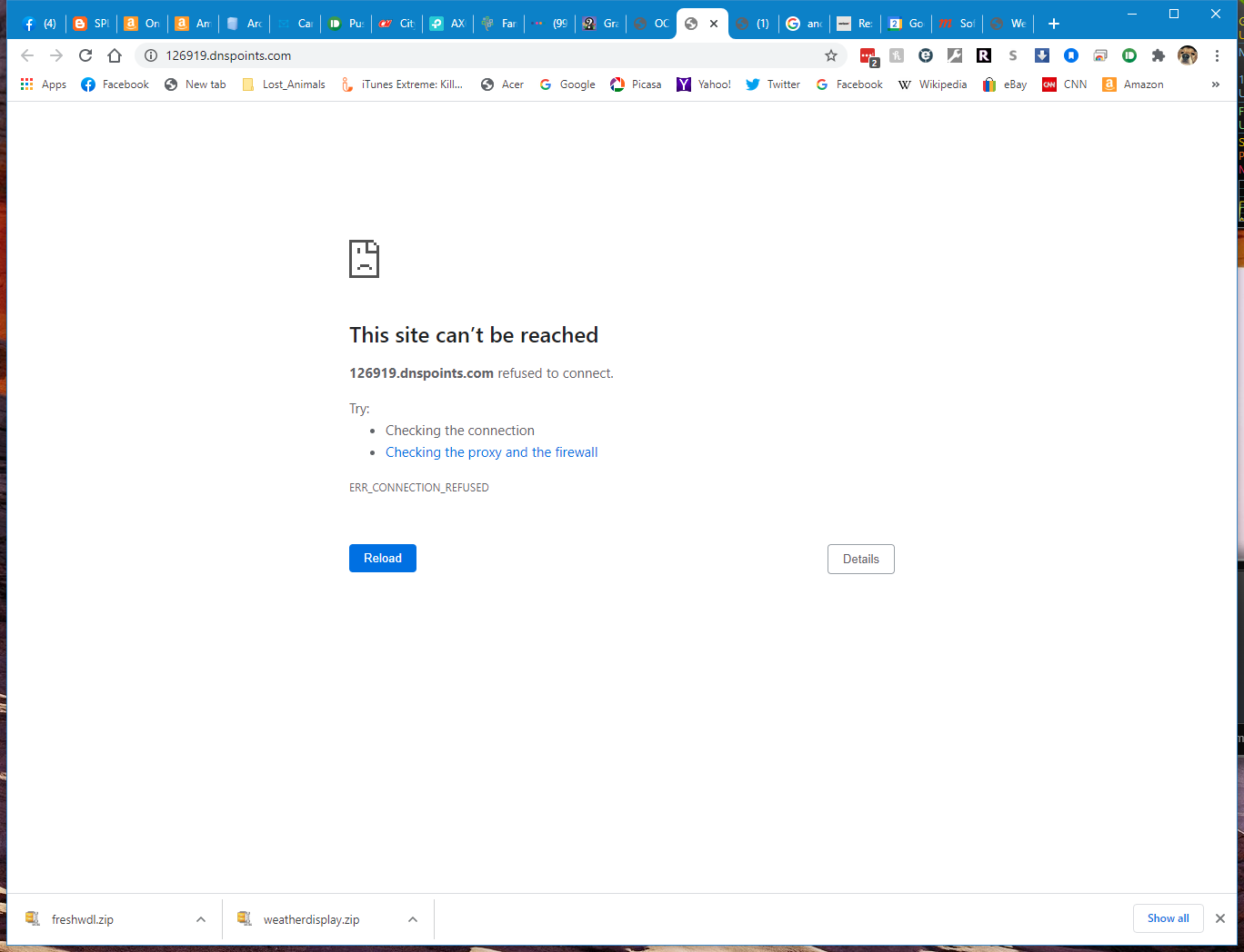

                                          I have not reset the hardware agent – though it looks like it wants me to, occasionally. Or reboot.
                                          The disconnected agent was the software agent. Stayed disconnected for 2-3 days -- regardless of internet / outages. It was not reconnecting, the service (Echo Networks) was running, internet was available so all I could figure to do was uninstall and reinstall the software agent. It is now active again but I have not rebooted this computer in over a day. (usually have to once a day) We can usually tell when we can't reach the internet -- either from the task bar on the computers or just not being able to reach.
                                          I am unsure how to tell that the provider is out vs something else -- your hardware agent is telling me it's "inside" but I look at the router and it says it is not communicating with the provider widget that is inside the house. I don't know how to test the provider widget or radio, but I don't think the 300 outages I experienced before the agents were installed came from inside the house.
                                          Not sure how to help you.
