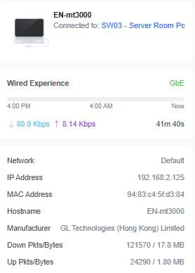

            It's connected to our switch on its WAN port, and it is getting an IP from our DHCP server, but I still cannot activate it. The device is blinking blue.

                              Hi, I can see that 130168 is active now. But I still cannot activate 131242.
                              The internet I use for this is a wireless one. It has a dish up our roof, and it is connected directly to our unifi switch. Our MSP set it up in a way that I can assign that internet connection to any port of any switches in our plant.
