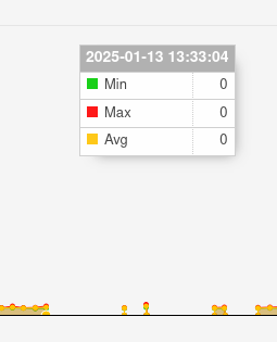

                                  • SBKS
                                    The 3 agents are recording a similar situation on Jan 13 at around 13:33 Chicago time but at the same time are not recording any type of outage.
                                    Two different technologies (Windows, Openwrt) and three different versions (MT300 and MT3000 even if they both are openwrt are different in binaries) but they all:
                                    • cannot identify an outage
                                    • are monitoring inactives
                                    • they disagree in some minor timing, which can be related to the way the three agents are connected to the LAN
                                    So next question is: is it possible, without any specific detail, understand if all three agents are connected the same way within the LAN (different VLANs, directly connected to the router or thru a switch, different rules in the firewall)
                                    A simple hand drawn picture is more than enough, as I said no company detail is needed, jsut trying to see where the problem is originated and why they behave in such a way.
