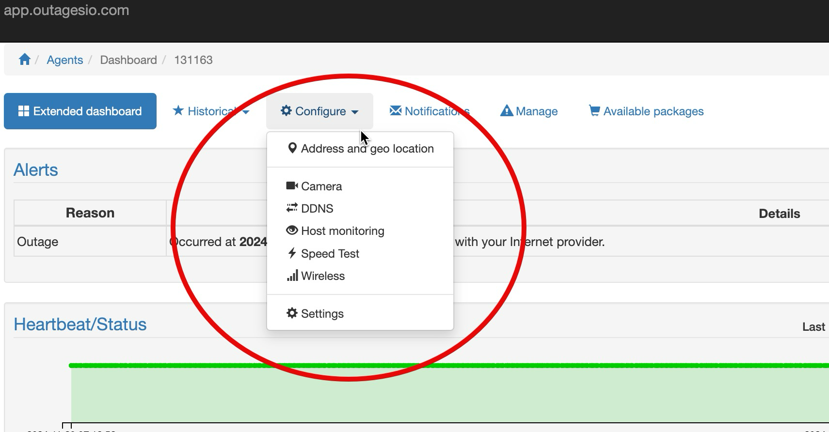

    I'm setting up two WAN devices and one WIFI device now and got the WAN devices setup with email alerts, however, on our Wifi device, I do not see an option to configure wireless. Ironically, I do see this option on the WAN devices. This is a screenshot from the config menu on the Wifi device:
    And this is the config setting for a WAN device:

          As far as I can see, IDs 131162 and 131163 are MT-300N-V2 (3 hundreds), while the 131166 is an MT-3000 (3 thousands), and for what I know, the code to manage the wireless has only been enabled for model 300 and not 3000.
          Again, not 100% sure of it, still checking it...

            I see. I checked 13166 and yes, the full model is: GL-MT-3000. However, this is a wireless device, shouldn't it have wireless in the config settings area?

                  https://www.outagesio.com/product/agent-with-2-5gbps-port/
                  In the link above I found this reference about the extra features: "Note that at this time, extra features such as camera/snapshots, built-in DNS server, Remote Access Service and Wireless monitoring are not available on this model. These features will be automatically rolled out to this agent in the future."
                  I know we are working to deliver all the functionalities also to this model but at the moment I have no ETA for it.
                  MT-300-V2 models have the ability to switch between wired and wireless connectivity and also to act as an access point.

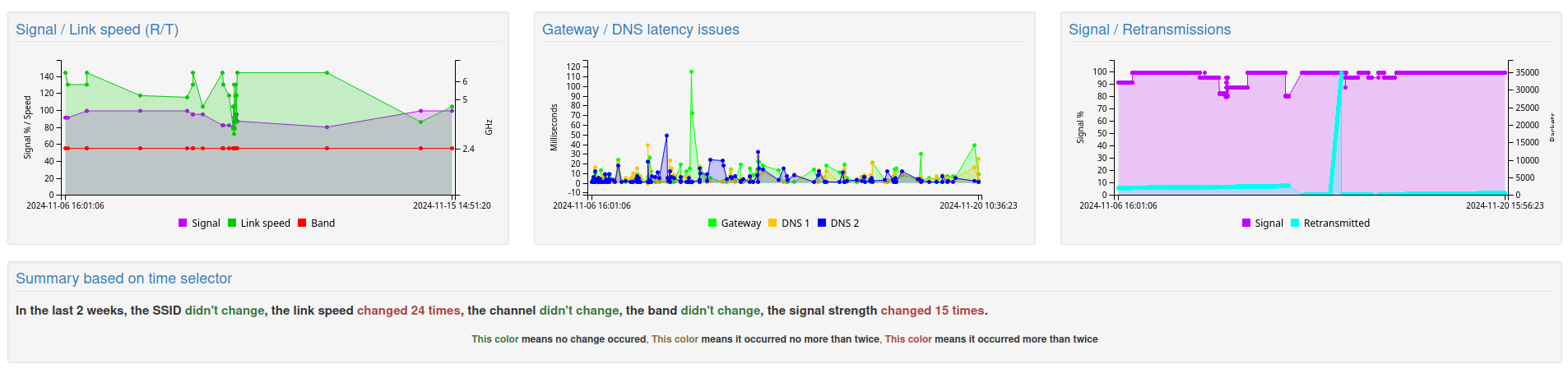

                  When you refer to "the ability to monitor wifi networks" are you referring to something like this?
