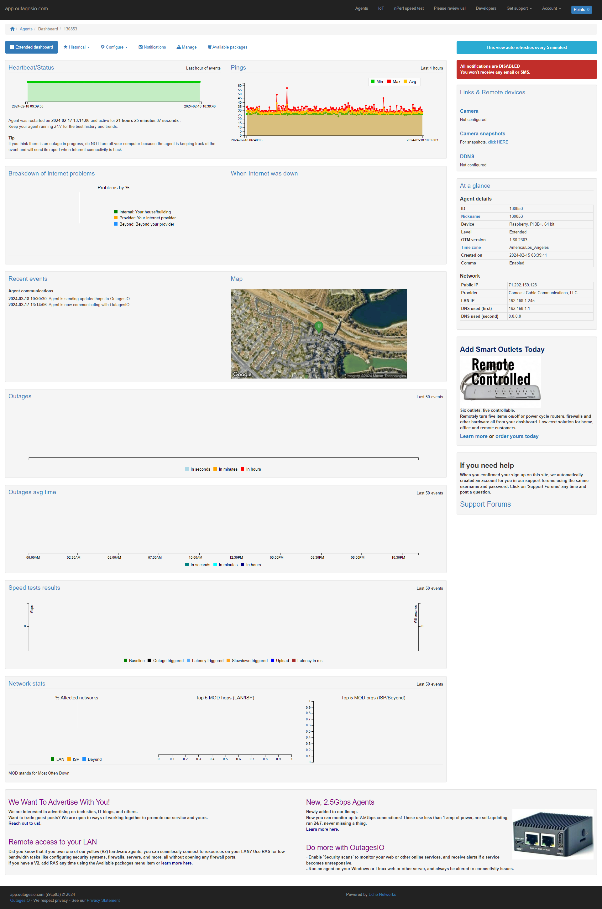

    I rebooted my router to test dashboard function. I can see the reboot in the Heartbeat/Status and Ping graphs, but nothing shows up in any of the other sections. Everything else is blank, with no info. Also, in the notifications config, I am unable to activate email or dashboard notifications. Am I missing something obvious, or is there a better method to test? Thanks for your help.OutagesIOSS1.pngOutagesSS2.png

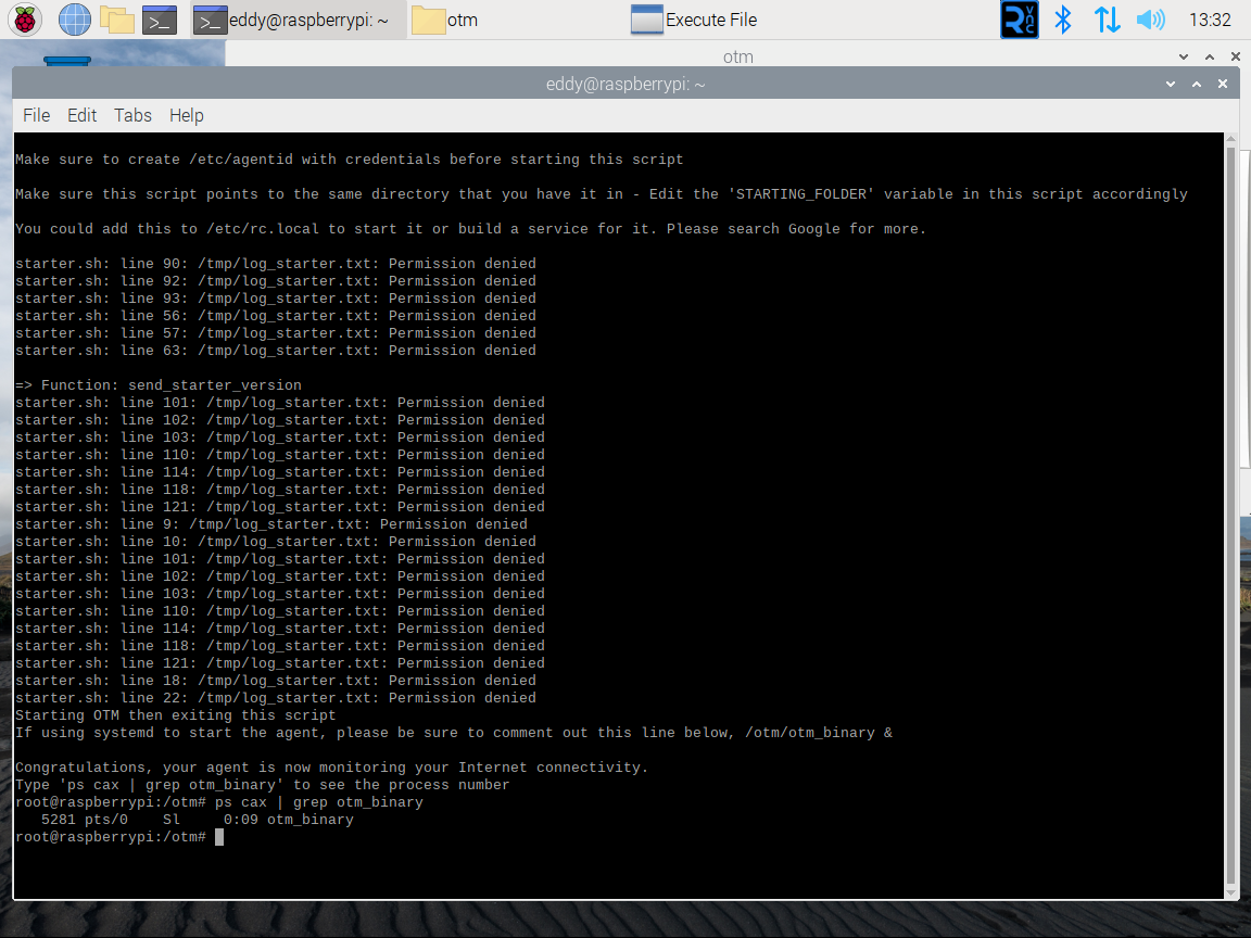

              I don't know why it would have stopped. It had been running for 20+ hours. Anyway, I got the agent running again by deleting the otm_binary and restarting manually, as it did not want to startup without deleting the otm_binary first. Not sure why.. Here is the console output when I ran the startup.sh :
              Says the agent is running, after the permissions errors for the log file. I still cannot activate email or dashboard notifications, nor any other feature. As if the account is still in the pre-staging dashboard. Is rebooting my router a good means to test the dashboard for an outage report? Thanks for your help.

                  The starter must run with admin privileges (i.e. sudo) and if you decide, as it seems, that you are running it manually and not as a service you have to check that the process is continuously running in background.

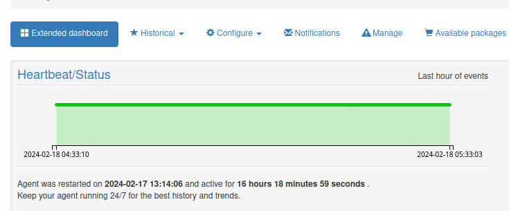

                  In this right moment the agent is working correctly, it is up and running as this message below the Heartbeat/Status graph is saying...
                  "Agent was restarted on 2024-02-17 13:14:06 and active for 16 hours 16 minutes 14 seconds .
                  Keep your agent running 24/7 for the best history and trends."

                      Also keep in mind that restarting your router is not an outage, it's considered a disconnection. The agent will always log IP outages when it detects them. Since there have not been any outages, there is nothing to log which is why you see nothing.
                      Data will only show up in your dashboard if/when outages happen. Remember that the main point of the service is to monitor your provider, the rest of the information is just FYI.

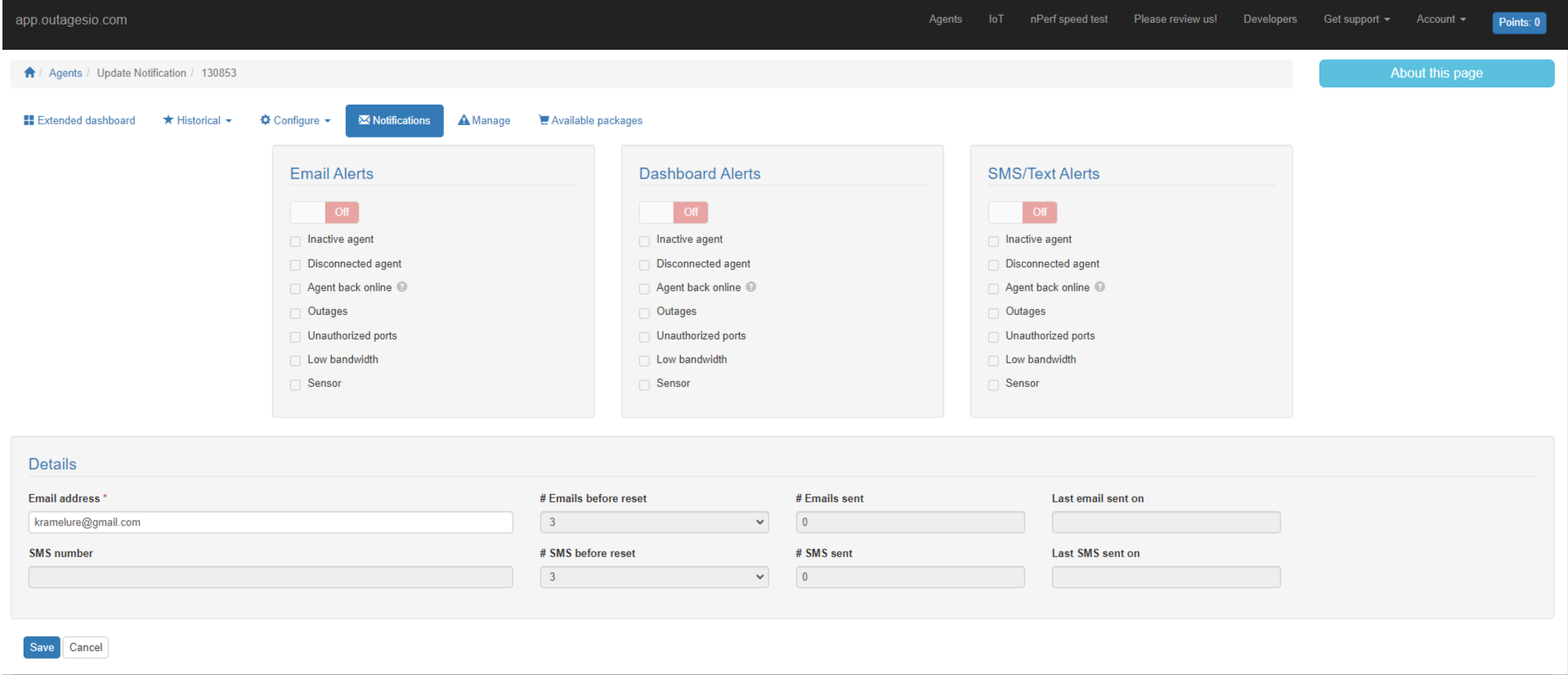

                        In the Notifications tab, I am unable to switch the sliders (email, dashboard) to 'On' position. I have tried on Firefox, Chrome, on PC, and Chromium on the Pi.

                            I now see what you are commenting
                            May I double check with you what kind of subscriptions did you buy?
                            I just see a sensor's one not an extended report
                            Is it correct ????
