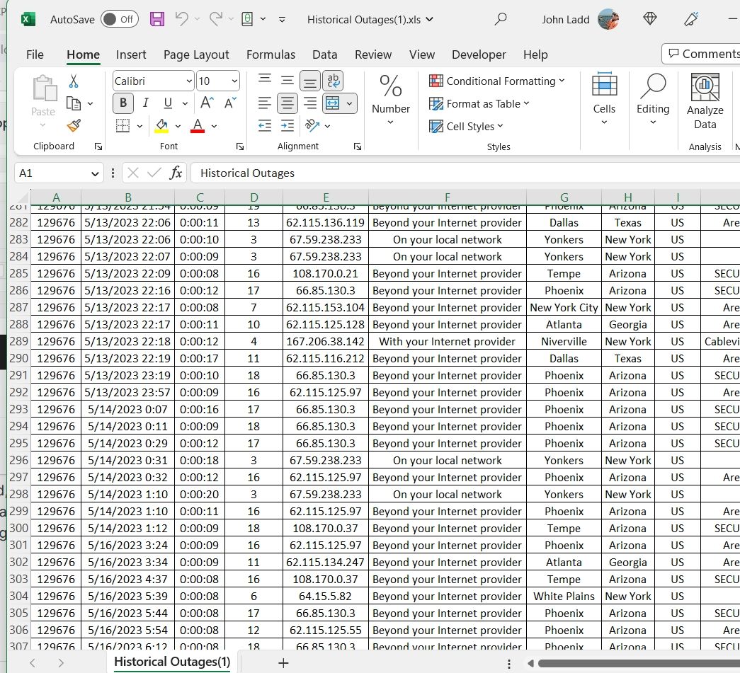

    I am confident that my internet service at a remote site was down for a day or more; however, once service was restored my hardware agent does not seem to record this outage at all. I am confident that my internet was down because my remote Google thermostat and camera reported that they had been down for a day or more.
    • J
      J
      jwladd
      adding to my previous post: On checking the dashboard bar graph of recent outages, I see that, as usual, there are many short (a few seconds) outages throughout most days; however, there is a gap of no outages from 1:10 on 5/24 to 3:24 on 5/16. This is the period of continuous outage. Why doesn't this large outage show up more conspicuously than the multi-second outages?

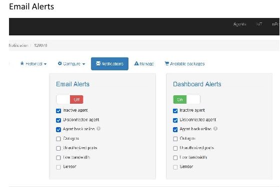

                  jwladd
                  Maybe I didn't have notifications set up properly on the dashboard, but I never received a notification about an inactive agent or disconnected agent. Possibly a notification was not in my primary Google inbox. what would be the sender's email address? I could use that to search my email.
                    I believe it's always 'noreply@outages.io' or 'noreply@outagesio.com'. I think there are some services still using 'outages.io' here and there on the back end.
                    If you share the agent and the date again, I can look in the logs. We get a copy of all outgoing email notifications specifically to always know that emails are going out.

                      jwladd
                      agent # 129676 out from ~ 5/14 1:12 until ~ 5/16 3:24
                      When I look at the historical record for this time period, nothing shows up.
                        This is what I see before and after that range;

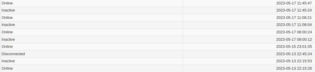

                        These are the emails sent;
                        And the reasons why;

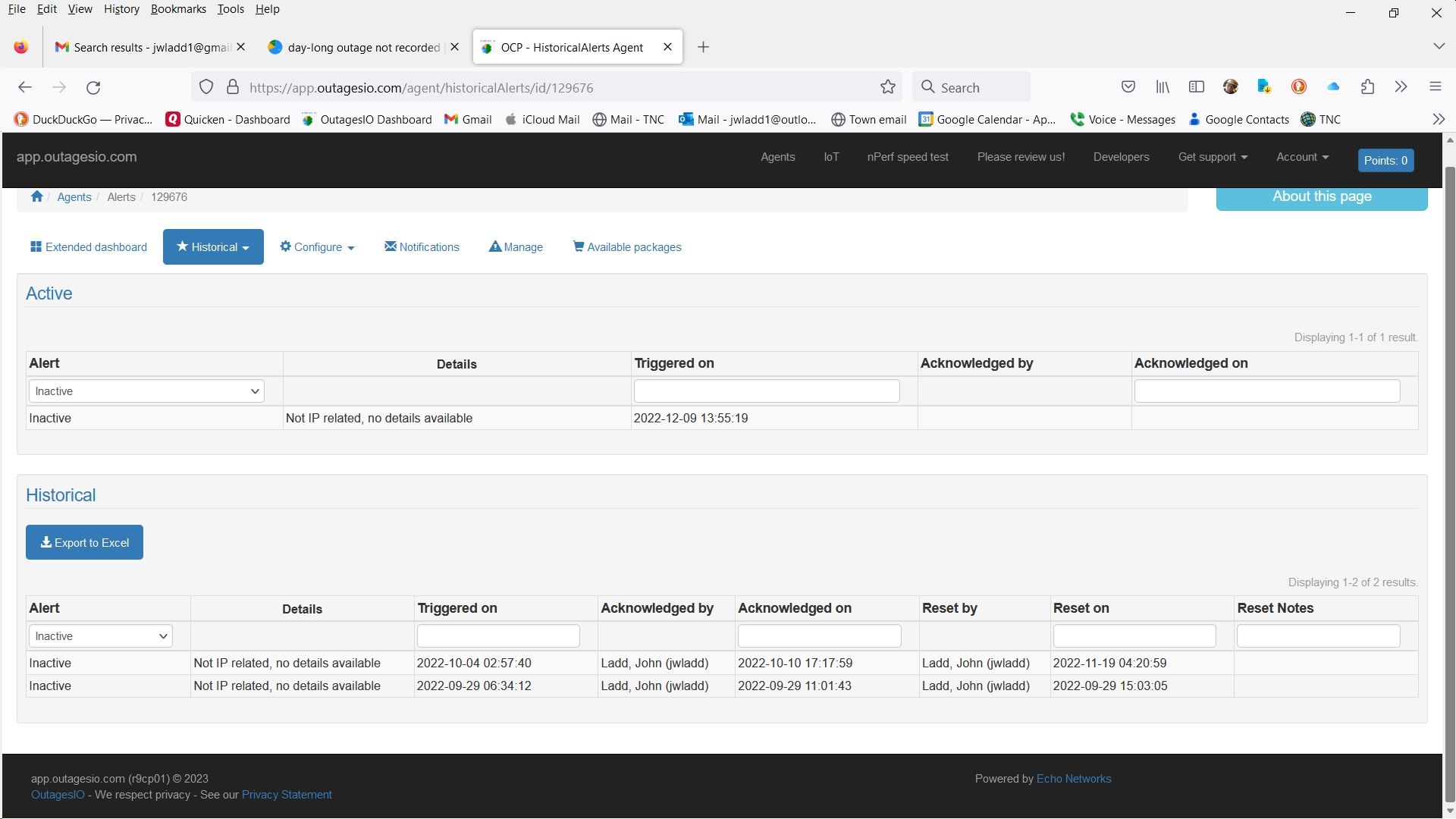

                          I can't see emails older than a month if they were in Span or Trash. Let's assume that I had email notifications set wrong during the time period May 14-May 16, so let's ignore the email question for the time being. However, I don't see the inactive events on my dashboard that you find in your logs.
                            Those are only available on the back end to help us with support.

                              jwladd
                              Also, as I noted in my initial post in this thread, I am fairly certain that I my Google IoTs were offline for a couple of days. If I understand correctly the log info that you just sent me, my internet service was out from 5/13 22:15 to 5/15 23:01; however the historical log of outages that I have shows short outages on 5/14 that implies internet connectivity on most of 5/14.
                                Keep in mind that the service is really meant only to monitor from your lan to and out of your provider. Anything 'beyond' is worthless since monitoring the Internet as a whole is not our function.
                                What I can say is you are experiencing most of the problems around 3am and 10pm and they are all very short other than the long one we've been talking about.
                                I would discount anything beyond the provider as the first step as those are only informational.
                                I would discount all inactive as those only mean your agent was not communicating for up to 30 seconds and that could be for any reason.
                                I would discount any Secured servers related ones also as those mean the agent wasn't able to reach our network but it made it past your ISP which is what really matters.
                                In other words, what you want to monitor is your provider only. If you see local network issues, those are things you have to look into locally and the rest is mainly about your provider.

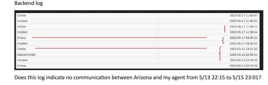

                                      jwladd
                                      Thanks for your patience. Let's start by getting me to understand your back end log. Does this log indicate no communication between Arizona and my agent from 5/13 22:15 to 5/15 23:01?.BackEndLog.jpg
