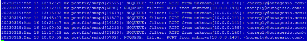

                        @OutagesIO_Support The message had the configuration of an email that the system would send, according to a post from y'all; OutagesIO - Agent ID 130142. See the post above dated Mar 18, 2023 10:21 am and 11:15 am and then just below that one at 12:01 and 1:37 pm. The notification was working then. I only set up notifications for outages under Email Alerts.
                          #32
                          The problem is that we aren't seeing any issues with outgoing emails. We monitor mail services to make sure they are always up and running.
                          It's difficult to know why an email would not have gone out or did but was never received.
                          This is all I know at this point.
                          The first email out was when the agent was created on the 18th.
                          Three emails went out on the 16th and the one at 2023-03-16 10:21:47 was the reports upgrade notification.
                          The rest on the 14th would be what ever other notifications you had enabled at the time.
                          The thing is, all of those went out and they made it to your email provider. The logs confirm they were received.
                          In almost all our communications, we ask members not to flag us as spam otherwise it can affect others using the same email service.
                          It's possible that an email provider blocks an email but for all intents and purposes, for the sending server, it made it.
                          I really cannot say why you missed an email but maybe keep an eye on it from this point on. If something happens, let us know immediately and we'll check the various logs to see what happened.
                          L 1 Reply Last reply

                            @OutagesIO_Support I'm getting emails about Inactive Agent (which I set up later than Outages). I've had 9 since 5:05 pm Thursday the 23rd but no Outages that show on the Dashboard as occuring on 2023-03-24 17:02:18 - Down (192.168.0.1) for 16s (Internal) and 2023-03-24 14:23:49 - Down (192.168.0.1) for 13s (Internal). As a side note, why limit them to 3 and then reset via Dashboard?
                            • L LTMiniard
                              #34
                              In terms of why we stop the emails after 3 is for two main reasons.
                              1: If we don't, people that leave the service typically flag the emails as spam rather than coming back to their dashboard to disable them.
                              We ended up being blacklisted too many times and getting blacklisted has the nasty effect of blocking wanted emails from other users of the same email service. We cannot take a chance at being blacklisted.
                              2: A lighter reason... we hope that people don't rely on emails along but keep an eye on their dashboards as much as possible in business situations at least.
                              It is better to let members know there is a problem to look into than send constant emails about the same thing. If there is a problem with inactives for example, an email or two tells the member so and the dashboard tells the rest.
                              I'll have to dig deeper on this email issue to find out what's going on. It's going to take a while however.
                              L 2 Replies Last reply

                                  @OutagesIO_Support Update on emails. Just noticed that I'm getting Disconnected emails. They look like they're coming at the time I'm shutting down my pc for the night. Still getting the Inactive Emails in 3's. Still no Outage emails.
                                  • L LTMiniard
                                    #37
                                    Yes, disconnected comes after around 29 minutes of being inactive. When members turn of PCs or servers running the agent, it becomes MIA to the network so gets a status change.
                                    Still looking into the outages emails point and have found a problem. They either aren't being sent or aren't being sent to all members. It will take a while to figure out why considering all of the other emails are being sent.
                                    In the meantime, you could use Inactive notifications but note that an inactive status occurs after an agent has not reported in for around under 30 seconds.
                                    Based on your reports, you have some kind of internal issue causing all of the inactive statuses. If your agent is on the LAN, behind the device that it complains about, you could try connecting that PC or a PC running the agent directly to the router/modem which might eliminate those so you don't get too many inactive emails.

                                      @OutagesIO_Support Thanks for the information. My pc, running the agent, is already connected to the router that is built into the modem through house wiring which is about 20' long. There are no other devices that use this port.
                                        #39
                                        Ok, just wanted to check since the gateway is what seems to be constantly going down on you for some reason.
                                        BTW, I thank you very much for sticking with the issue of the outages notifications.
                                        We could see that outages were no longer being entered into the database as of 2023-03-21 13:19:34. That was the last entry.
                                        After many hours spent digging, we found that problem and fixed it which caused a massive number of outages to come in from agents that had them backed up, waiting to re-send.
                                        We also saw an equal amount of emails going out and that caused some mail servers to defer receiving so they will make it over time but may end up in trash/spam folders due to the excessive number of emails that were sent instantly.
                                        I don't yet know if this was the only problem so if you can let us know how it goes from this point on, that would be great. I noticed your notifications are currently disabled.
                                          #40
                                          I see that you did get an outage and have your notifications on. However, I don't know if that happened before or after we fixed the mail problem.
                                          Let us know once you see something.
