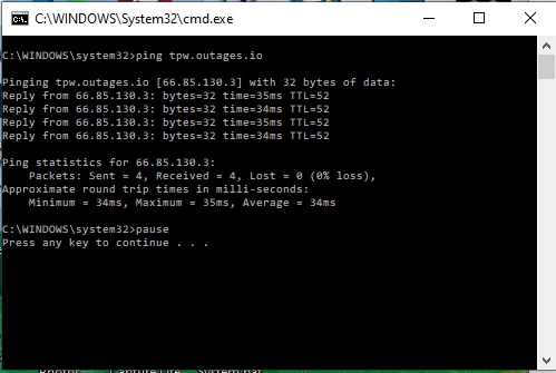

Finally, when you see your agent status as Inactive or disconnected but feel the PC is still communicating over the Internet, can you try pinging tpw.outages.io from that same PC exactly when you are seeing that status.
The way the agent works is that it's using the ping mainly to have a constant known destination. It's always possible one path cannot reach something while we're still using the device with other paths. Although in this case, it might be related to what we were working on over the last few days.

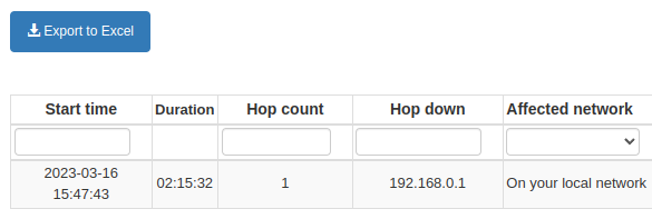

Thanks for the reply and information. Just for your information, yesterday I was not on my PC for most of the afternoon, so I missed an event that concerned me. Last night (16 March about10:30 pm CDT) I logged onto my dashboard and saw this message regarding my internet service. "2023-03-16 15:47:43 - Down (192.168.0.1) for 2h 15m 32s (Internal). My dashboard was working as expected when I logged on, no issues. I get a couple of internet interrupts every day but at most they about 10 - 20 seconds. This is a long, ongoing occurrence and you guys have tried to figure out what's causing it.

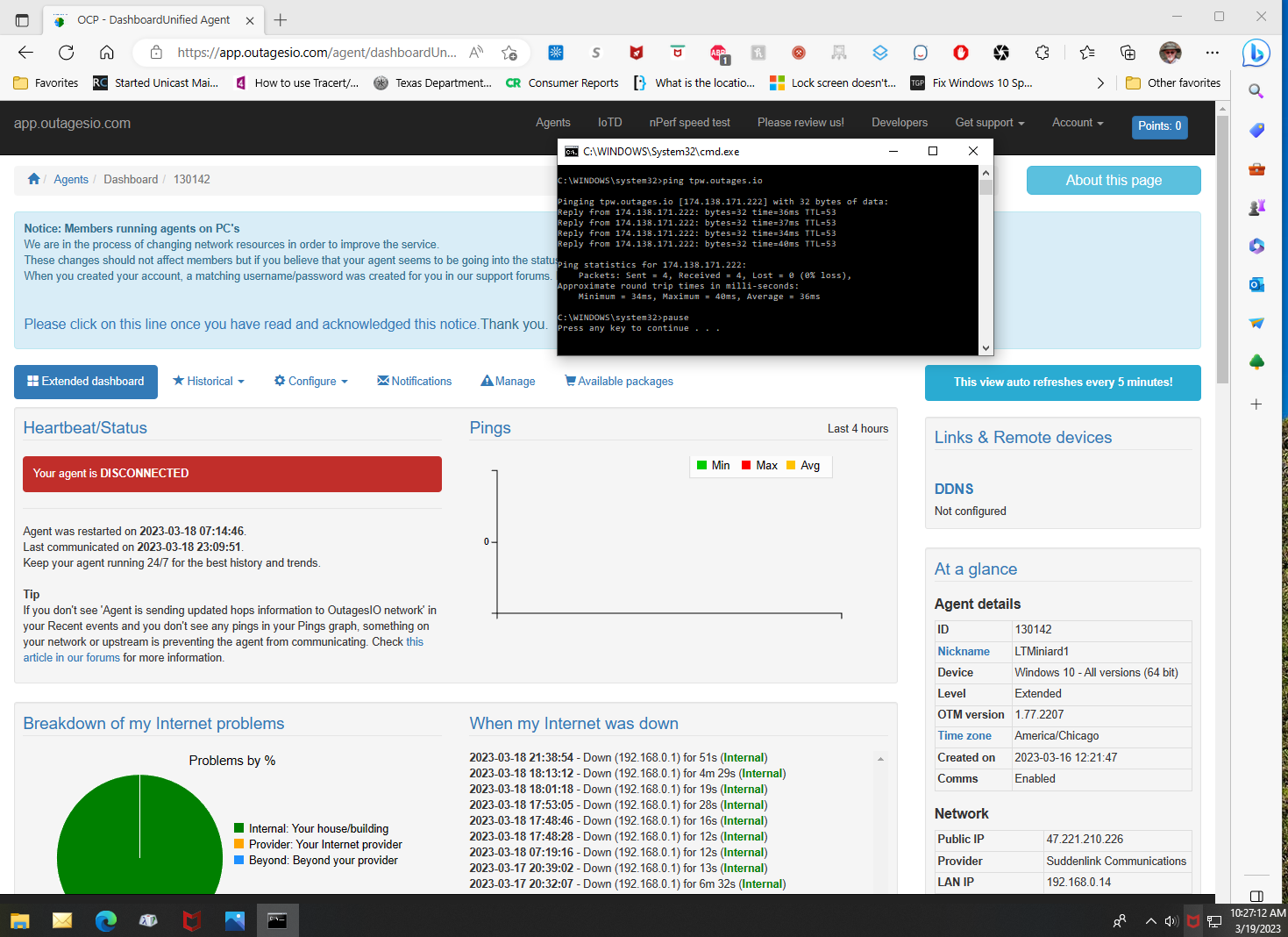

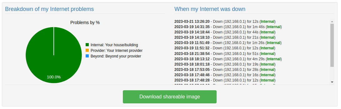

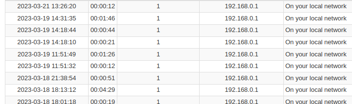

Ok, so, what I see is not what I expected.
This is an outage. It means the agent was not able to reach that device, presumably your local firewall/router based on looking at the hops it's sending.
The fact that it's local makes it pretty hard to know what happened. The service is mostly about monitoring Internet providers, the rest is just 'bonus' if it helps :).
What's interesting however is those hops. Is that device in a data center or a high level network because those hops are really a bit odd.
I've upgraded your agent to Extended so you can see what I'm seeing. Maybe you can shed a bit more light to help determine what happened.
The work we're doing should not have affected this event or caused it either. It looks like a genuine outages, but a local one.

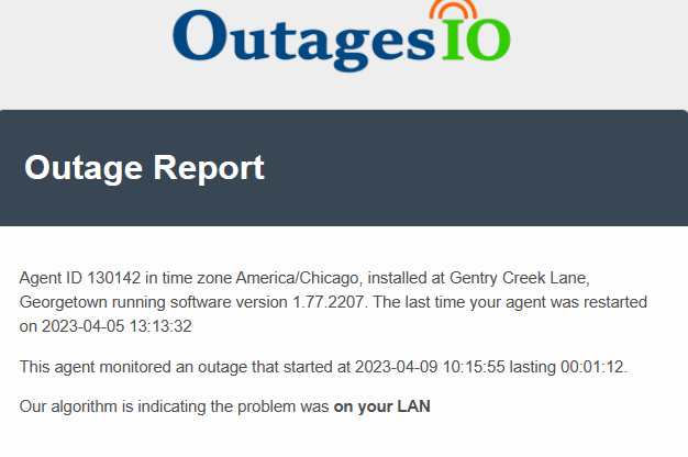

Just look at any of the emails you've received so far, they are all from the same email servers.
Subject always starts with OutagesIO
Subject: OutagesIO - Agent ID xxxxxx...
From: OutagesIO noreply@outagesio.com
To: "xx@xxl.com" xx@xxl.comSMTP server example;
Return-Path: noreply@outagesio.com

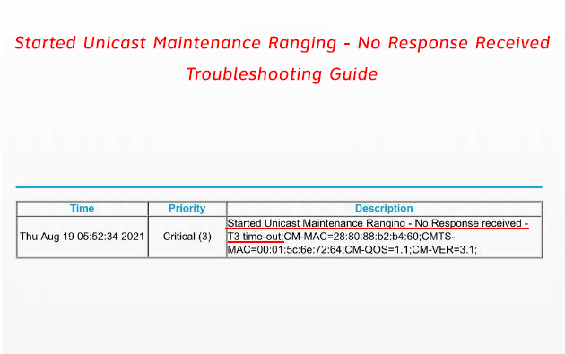

@OutagesIO_Support It's happening again. Disconnected but still have internet access. Tried the ping to tpw.outages.io as recommended. See attached screen shot below. As a side note I found many error messages in my modem log, they were similar to this.
I did a complete clean of all fittings for my modem router all the way back to the cable box on the exterior of the house. That appears to have fixed the problem of the error messages, none since 2023-03-18 18:13:12 - Down (192.168.0.1) for 4m 29s (Internal) although I still had 1 drop in internet later.

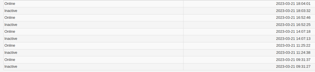

I am also having this problem. My dashboard says Disconnected and stops reporting. I checked this on both Chrome and Edge browsers. I can ping tpw.outages.io with no problem.
When I restart the agent, both browsers start reporting again. The agent ID is 130148.
