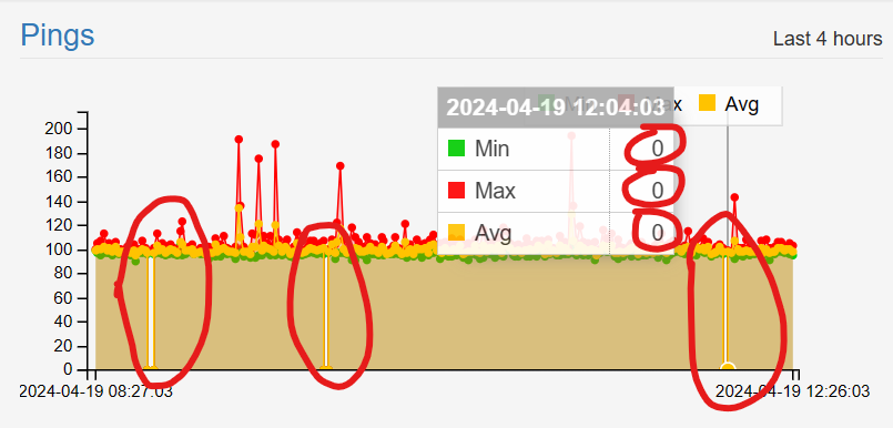

I have white gaps in my Pings G\graph on the Dashboard. What are they and why. Also, there is a gap in Heartbeat/Status that looks like the time I got the When my Internet was down 2023-01-17 09:50:39 - Down (192.168.0.1) for 50s (Internal). What does (Internal) mean. See the screen snip. Can I view the graphs in a large scale?

Internal means something on the network was the location of the problem. If the provider for example had some problems that caused short or long outages, the agent, assuming it's not stopped during an outage, will log those events and show them as outages if they are IP related.
Any time you see missing pings or inactive but without outages associated with the same time/date, it means that something else happened, preventing the agent from communicating with OutagesIO.
The heartbeat graph is partly generated by pings and communications with the agent. If pings don't make it or if the agent doesn't communicate for x number of seconds, there will be gaps.
If there was an outage during that time, that will be logged and shown in your events. If there was no outage, then you'll only see a gap.I mentioned IP related above and that's because depending on how your service is provided, cable, wireless for example, there are other things than only outages that can occur.
This article explains what some other causes can be.
For cable and wireless, the problems are usually signal levels, something that monitoring cannot detect since they aren't IP related. Take a look at that article and let me know if you need additional clarification of something and I'll certainly try to help.

@OutagesIO_Support Thanks for the prompt reply and info. The size of the graph is small and once you have much data on it, it's hard to determine the amount of time the lack of data caused the white gaps. Making a larger graph would help or some magnifier function would be great; kind of like on Amazon where when you roll your cursor over an item and magnified field pops up. Or maybe even better would be to add a list of those breaks, like the "When my Internet was down"
The same goes for the Heartbeat/Status graph.

Let me highlight few things before I will dive into your agent's issue.The idea behind the "pings gaps" is to show in a graph when the pings are not reaching our receivers (our network's servers in charge of this feature).
This "not reaching" can be explained with:
- a real missing connection to our network meaning the agent becomes inactive, disconnected or abandoned, please check https://support.outagesio.com/topic/55/manage-agents-menu for further explanations of the "offline" status
- a temporary overload of local (your) or remote (our) network
- an error in the local agent associated to the multi-threading nature of the agent app
- a network outage

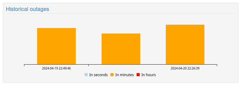

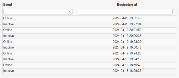

I do see that your agent has had 3 outages and this reflects only part of the "missing pings"
but I also see that from April 18 your connection was inactive few more times:
In your case I tend to believe it is option 1 but I have opened an internal ticket to be sure we are not in option 3 for the agent 130916.
