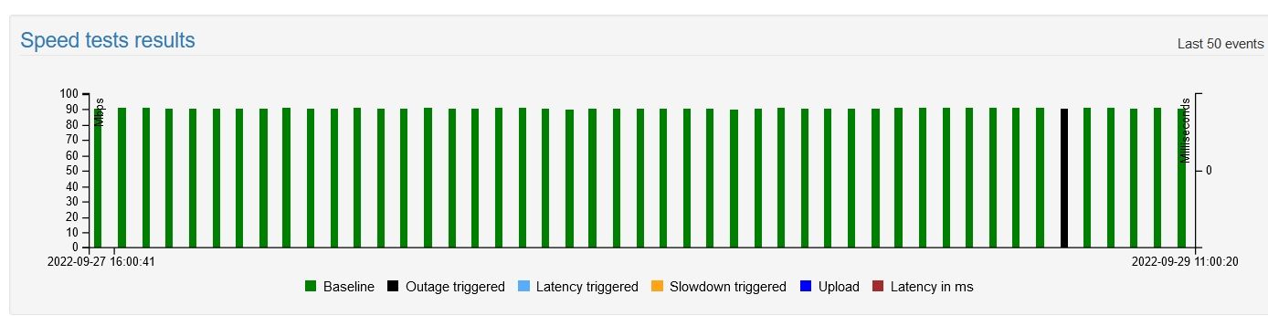

    I am puzzled by a couple of things related to speed tests:
    1. what is causing the notice to "check the speed you set ..."?

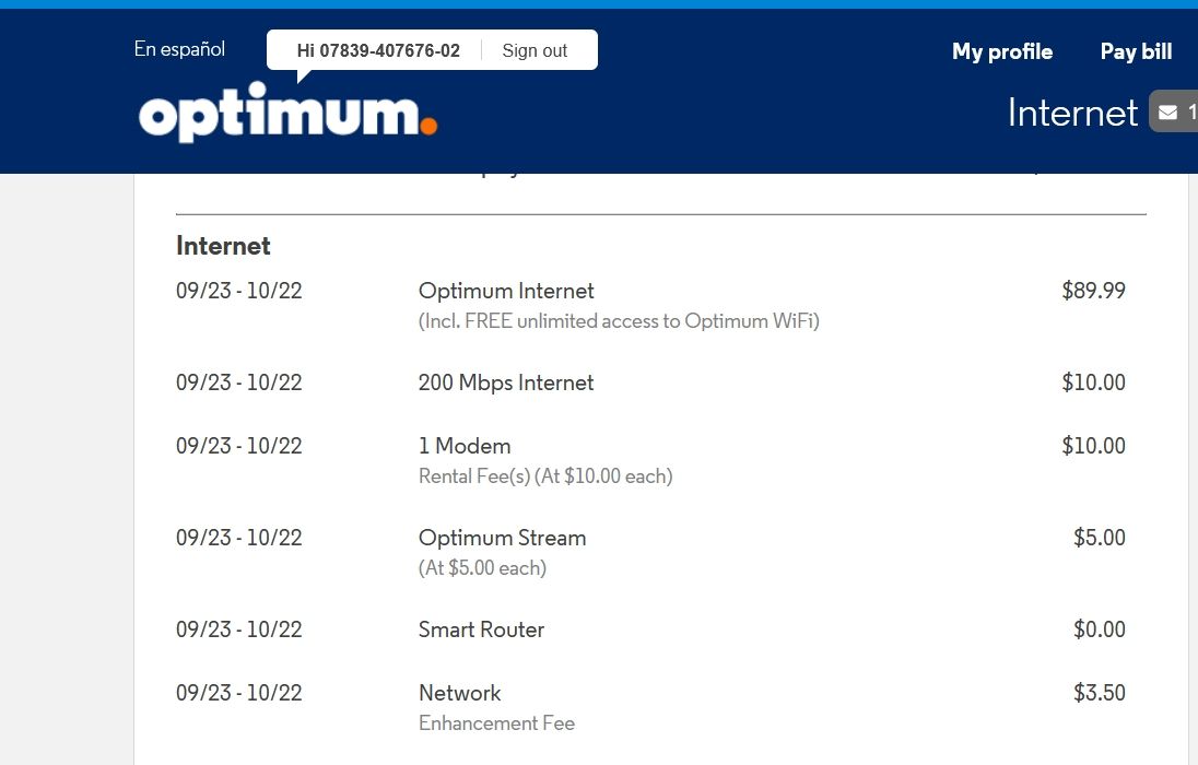

      attachedSpeedTestSettings.jpg shows my speed test settings. The attached SpeedTest.jpg shows the results of my speed tests - averaging 90 Mbps. The attached OptimumBill.jpg shows a portion of my Optimum bill showing that I am paying for 200 Mbps.

      Outagesio indicates a speed of ~90 Mbps. Other speed test sites report speeds > 200 Mbps. why the difference?
        I'm assuming you didn't notice the mention in the purchase page. These agents have 100Mbps ports so with our app running on it, it would max out below 100Mbps.
        The point of the speed test isn't really to see if you can max out the connection but to see if you have a usable amount of bandwidth.
        For example, even with a 100Mbps max, if you were seeing 5 or 10Mbps for example, you would know there is something really wrong.
