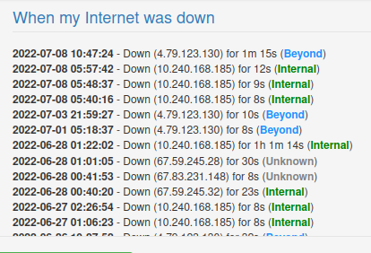

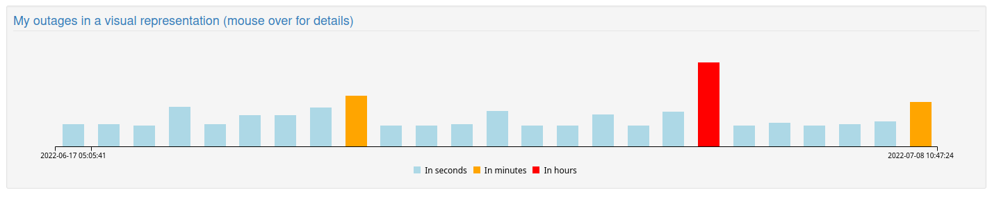

        If I check the dashboard I can see a bunch of outages happening in the last month

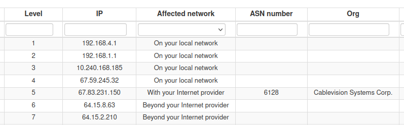

        What maybe is wrong is the auto detection of the affected network i.e. the hops, this is what I see:
        I bet the real problem is that the topology of your connection to the internet is not as shown in the hops sine the system automatically determined that you have at least 4 before accessing to the provider which I bet is wrong.
        This usually happens if there is a wireless/radio connection between your router and the internet provider.
        Always in the dashboard you can see this:
        and you can immediately connect the dots since the ip 10.240.168.285 is considered within your network but i bet it is already outside.
        If you can please explain a bit more how you are connected to the internet maybe I can help fixing this automatic setting.

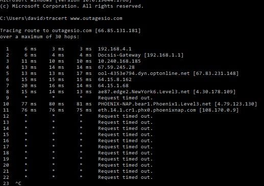

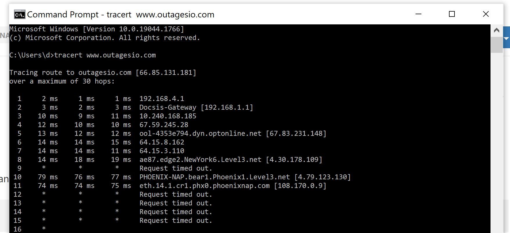

            If installed in your windows pc you can run from the command prompt the following command:
            tracert www.outagesio.com
            and paste the result of that here just to confirm what we see
            Then I can tell that your router is 192.168.4.1 but strangely after this router you go to another gateway which is 192.168.1.1 which either way is the provider connection or soemthing you have at your site
            i.e.
            most probably your provider is already at the third hop 10.240.168.185

                And yes I can see the screenshot and apart from 192.168.4.1 which is clearly your router what is the "Docsis-Gateway" associated to IP 192.168.1.1 ???

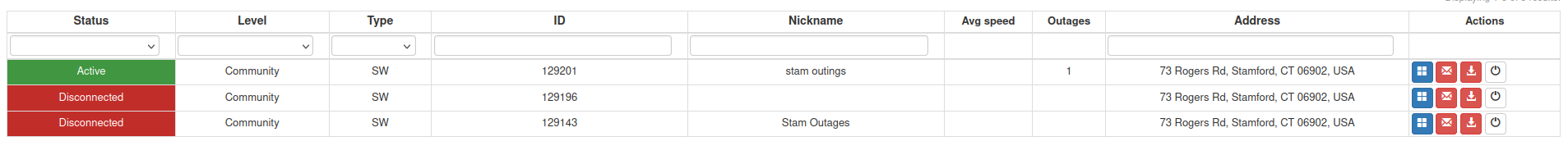

                      Lets start from the list of agent that you can see when you are HERE
                      This is what you see
                      If I dive deep into the step you have taken to create those 3 agents I can see that the ids 129143 and 129196 are the same hardware so it means that probably you installed more than once the software on that PC.
                      My suggestions would be:
                      • delete one of those agents, you can do that going to the dashboard, choosing the Manage menu and then the option to delete it
                      • Uninstall the software from that PC (check eventually that it has been installed more than once and remove them all)
                      • Only at this point use the option Reinstall from the same Manage menu and follow the instructions
                      Now you should have only two agents i.e. two PCs where the software has been installed.
                      In this "new scenario" you can decide to leave one PC at home always powered on (otherwise the agent cannot give you any clue about what is happening to the internet connection!) and the other with you (you can use it to know how the other networks you are performing while traveling).
                      I hope I got it right, but you dont need to leave the dashboard open to have the agent working since the agent runs as a service in the Windows PC you installed and that is the component sending the data to our servers.
                      The dashboard can be accessed anywhere you are to see the result of the agent collecting data.
                      I saw you did assign them a meaningful nickname so we can refer to the agent with that instead of their ID.
                      In this way I can try to help on which type of outage is reported.

                        About the Docsis Gateway I need to be sure I get this right so let's start with some assumptions...
                        If I look at the TraceRoute you executed while you were connected to the network that is having outages I can see the following:
                        • the agent has an IP belonging to the 192.168.4.x network (I can see 192.168.4.83)
                        • which is confirmed by the first hop which is the agent's gateway i.e. 192.168.4.1
                        • but you are telling me that the Docsis Gateway is very probably your router which is the next hop i.e. 192.168.1.1
                        So I am assuming that either you are using a virtual PC or the router has been configured to isolate the LAN network: again these are assumptions since I have no idea how really is your configuration.
                        No matter what I just said I can say now that very probably your provider is at your 4 hop where the address 10.240.168.185 shows up and that is exactly the IP that is mainly having outages together with some other after that one.
                        If that is the case then I can override the automatic discovery made by the agent so it can consider the correct network from that IP on (would do that anyway after the previous post where i suggest to reinstall the software).
                        If my assumptions are correct, I can see some relationship between the outages you are mentioning and the ones discovered by the agent but let me repeat myself: some disconnections could be absolutely NOT related to the so called IP outages.

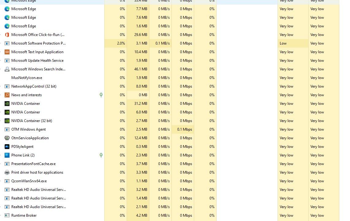

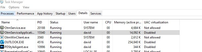

                          deleted the agent, but can't figure out how to uninstall the software. what's it's name? i tried outages, nutpile, io, etc

                              @dberges
                              Look for the Echo networks service in your installed programs.
