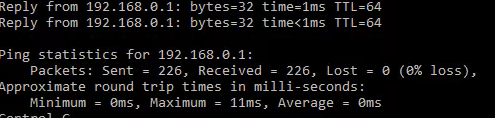

I started a continuous ping request from command prompt from a PC connected to the network at 9:34am and stopped it at 9:38am (local time) and there was no packet loss :

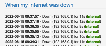

but agent reports packet losses on that time frame :

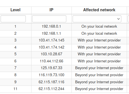

If I check the hops found by the agent I see this:
Can you please explain what the 192.168.1.1 is and why I do see it after the 0.1 before accessing the WAN interface?

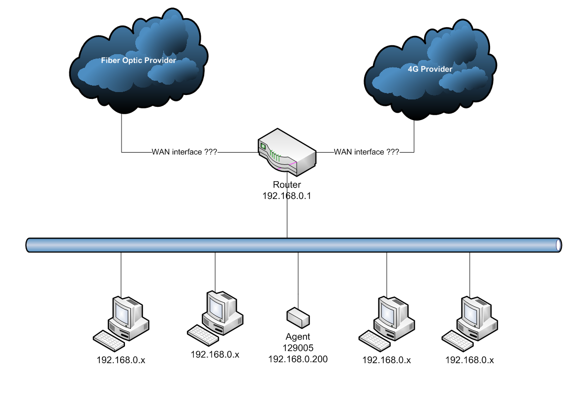

Sorry for asking again but I need to understand first what is 192.168.1.1 and where is physically connected in the image I decided to build based on your description

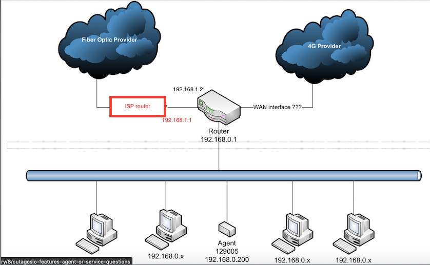

I did a quick edit to your picture (the IP address of the 4G interface is dynamic so I didn't edit it) :

I am not sure why you say the info is incorrect but I am open to see it when I understand what are you are meaning with it.In the image I shared before you can see that the only path that is recognized for now is the one going from 192.168.0.200 to 192.168.0.1 (your gateway) to 192.168.1.1 (your ISP router) and from there out into the provider's network.
I am assuming that the 192.168.1.2 is the IP associated to the WAN interface connected to the ISP router.
I am also assuming, as per my image, that your router has two different WAN interfaces (one for the wired provider and the other for the 4G provider)Said so, my first attempt to understand the outages associated to 192.168.0.1 is that your router is going down when is managing the "move" from the wired to the wireless provider meaning it is having a short delay in doing the hand-over
Again it is a very first attempt in trying to explain what the agent sees. -

Again it is a very first attempt in trying to explain what the agent sees.@SBK No matter if it's the primary WAN is up or not, 192.168.0.1 always remains up even during the failover or failback process. I verified this in my first post.
That's why I said the agent reports something incorrect, because it reports that 192.168.0.1 is down when actually 192.168.1.1 is down.
