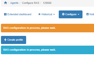

    So this is my second testing of RAS. To start, I created 5 profiles for different network devices (a printer, a backup device, an industrial machine, a PBX, and a Ubiquiti web console). To create a profile, you just need to give it a profile name, the LAN IP (local IP), LAN port (80 or 443), url type, and the public IP of the one who is going to access it. For my testing, I used the public IP of our secondary ISP, which is entirely separated from the corporate network.
    After clicking on Create, the profile is Inactive by default, and you need to click the Enable (thumbs up button). It took 2-3 minutes before it becomes enabled. I noticed that whenever a profile is enabled, then the EDIT button will be greyed out. You can only edit the profile again by deactivating it.
    So this is how it looks like:
    Out of the 5 Profiles, only the Ubiquiti console worked. I have tried several setting combinations but unfortunately it still didn't work.
