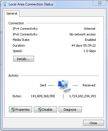

Your speeds have gone as low as 5.44Mbps which is incredible considering you said you have a 1GB connection.
The highest speed test recorded was 108.61Mbps which is almost 900Mbps less than what you are paying for. This leads to wonder if your PC has a 100Mbps card install and not a 1Gigabit card or that your router has 100Mbps ports rather than 1Gibabit.
You should take a look at what speed your PC network is running at. It will look something like this.

My desktop is fairly old and the card is 100mps - which explains the slower speed on that computer. I do all my work, etc on my wireless tablets and phones which are newer.
The desktop is cabled, with a new cable, to the 1 gig port in my new router which is AX3000, about a year old, high end

My desktop is fairly old and the card is 100mps - which explains >the slower speed on that computer. I do all my work, etc on my >wireless tablets and phones which are newer.
That's fine. People should not be testing full speeds all day long anyhow. What we really want to know since it's shared bandwidth is that we have enough to work with. Your bandwidth seems fine then, at least very consistently usable but there is some other problem with the connection. This also leads me to believe bad cable or signal levels problem / bad interface on the providers side IF you determine it is not on your side.
