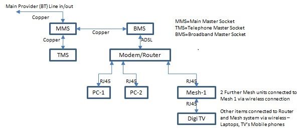

        If possible, can you show me a basic diagram of your setup?
        lan-firewall-router-providers device
        Something along those lines?

          Basically my set-up is not very complicated.
          Connection into the house
          Note - Rooms 1, 2 and 3 are downstairs and room 4 is upstairs.
          Copper wire connection into a BT 5C Mk 4 Master Socket in room 1 - (We are approx 1.5 miles from the exchange so speed is limited by the distance and getting circa 7Mbs is REALLY good!) No fibre available. Have been offered Fibre to the cabinet (existing copper to the house) with a guaranteed speed of ….......1Mbs!!!
          Master socket is already filtered internally and was fitted by Open Reach engineers (Provider engineering firm).
          Cable is then split from the Master Socket into separate telephone line and Broadband line - This was also done by the Open Reach engineer.
          Telephone:
          Telephone line goes to one socket in room 4. We removed the filter after the 5C socket was installed, as advised by the engineers. We have since tried the phone connection with and without the additional filter (makes no difference). We then have wireless telephone set-up through the house so no additional phones or sockets connected.
          Broadband:
          Cable from Master socket goes to a Broadband master socket in room 2 (also installed by open Reach engineer)
          Broadband Master Socket connected via ADSL Cable straight into Combined Modem Router (TP-Link VR900EU Ver 1.0) (in room 2)
          LAN Cable from TP-Link router to PC 1, (In room 2)
          Lan Cable from TP-Link router to PC2 (In room 2) - Outages tool is installed on this PC and is always on.
          Lan Cable from TP-Link router to Mesh Router1-Master (MERCUSYS) (In room 3)
          LAN Cable from Mesh Router 1 to Sky Digital TV box (In room 3)
          Recent change:
          TP-Link settings changed - IP address changed in order to get it to automatically re-connect following loss of broadband connection. Not always re-connecting but more often than not.
          Noted more "Internal" disconnects after these settings were changed.

            Can you tell me how I can add a picture - Diagram?

                When you write a reply, you should see Options and Attachments just below the edit window. Is that showing up?
                If so, click on Attachments, Add files and once uploaded, click on the inline option.

                Sure, if you could get a diagram up, that could help as a next step.

                  Thanks for the updated comments. Home Network diagram is now attached.

                    Thank you for the diagram.
                    I am surprised that they told you to remove the filter but since I've not personally dealt with DSL in a long time, maybe things have changed.

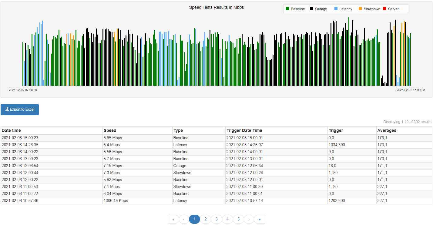

                      However, I'm now 5 days in and have started to get Outage speed tests showing (Black bars on the graph) yet there is no outage
                      shown on the outages graph or the "why my internet was down" list in light view.
                      Can anyone tell me why this might be?
                      This is a bug in the speed testing algorithm. There is a condition where the agent thinks there is a problem such as latency or a slow down which triggers these speed tests. The black bar is only supposed to show up after an outage.
                      The idea behind running the speed test after an outage is that over time, it might show a trend. It's not all that useful since speeds are constantly changing and typically, right after an outage, speeds are way back up at least for a while.
                      The reports are all about trends, it's what you see over longer periods of time but when you don't see an outage yet see the black bars, that's a bug we've been trying to iron out.
