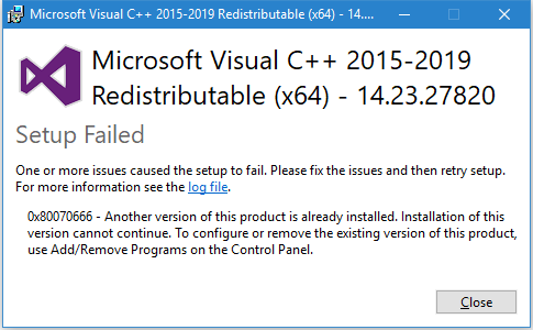

                              lklawrie
                              #21
                              Searched registry on main machine. Did not find Echo Networks or Nutpile in any entry.
                              Tried to install old vcredist, quick fail: (also says another version of this product is installed so cannot continue)

                              [2968:5DEC][2020-11-04T11:59:28]i000: Setting numeric variable 'EulaAcceptCheckbox' to value 1
                              [2968:5DEC][2020-11-04T11:59:28]e000: Error 0x80070666: Cannot install a product when a newer version is installed.
                              SO I guess I will try uninstalling this version and see if that helps. (FYI my removal software says it was installed on 10/30 – which is probably when I started this process?)

                                The additional .NET package was provided because Microsoft had not pushed it at the time and it was needed for the installer to complete.
                                As you can tell in this case, your PC already has it installed which is why that failed.
                                Looks like we have to wait for the developer to give us some insight.

                                    #24
                                    Okay, removed that 2015-2019 bundle that was installed on 10/30
                                    Got past that – entered my "credentials" and now get the error the other machine got.
                                    Again, newer log in the dropbox folder.
                                    Now, just wonder what won't work....
                                    This time shows that 2015-2019 redistributable, 32 bit, installed on 11/4. 14.23.27820 version.
                                    The one I removed was 14.24.28127
                                    Linda
