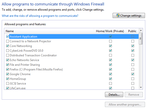

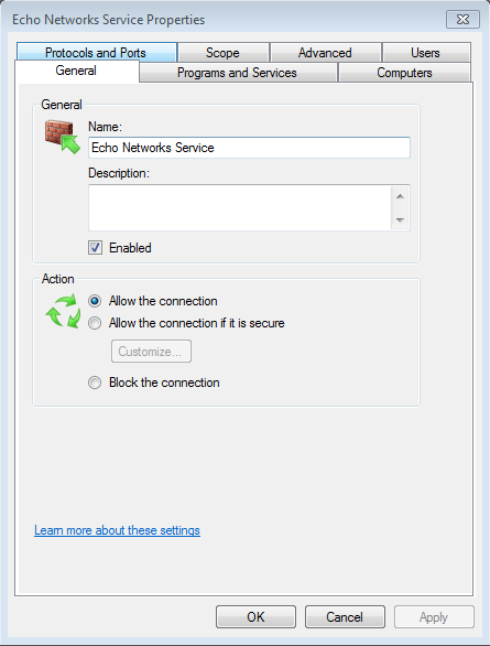

              You mentioned seeing the rule, does it allow All? On my win7, this is what the rule looks like.
              The OutagesIO agent only uses ports 80, 443 and some ICMP ports are one part of some tests to determine if there is an actual outages or not. It is completely safe to give it All access.
