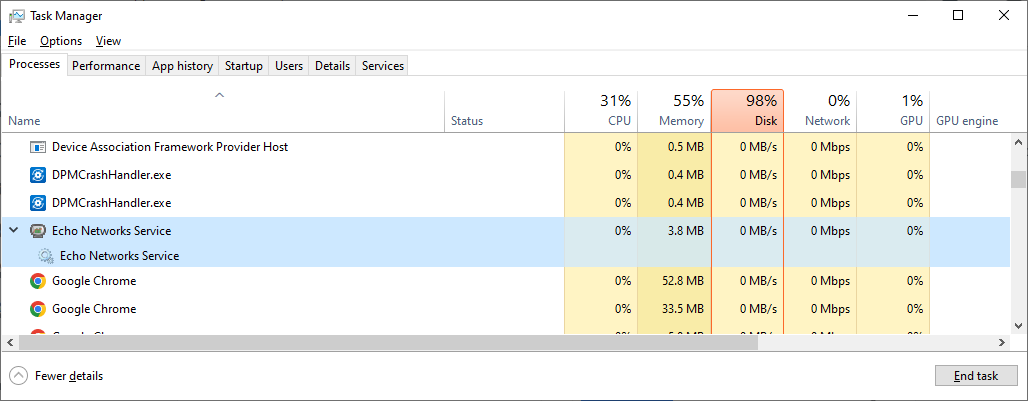

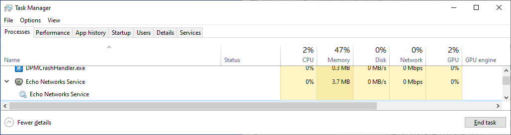

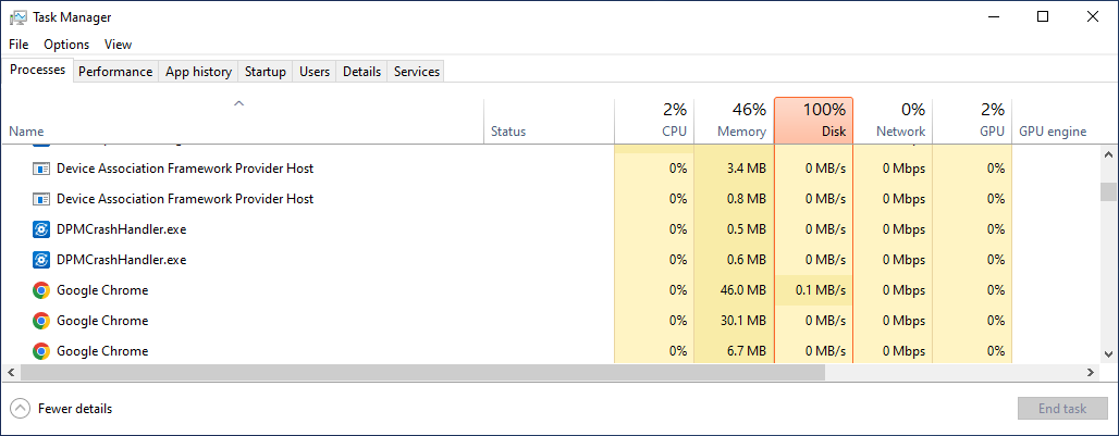

      Sorry, not Driver, it was the Agent I uninstalled. Repeated uninstall today. Checked Task Manager and didn't find Echo Networks Service.

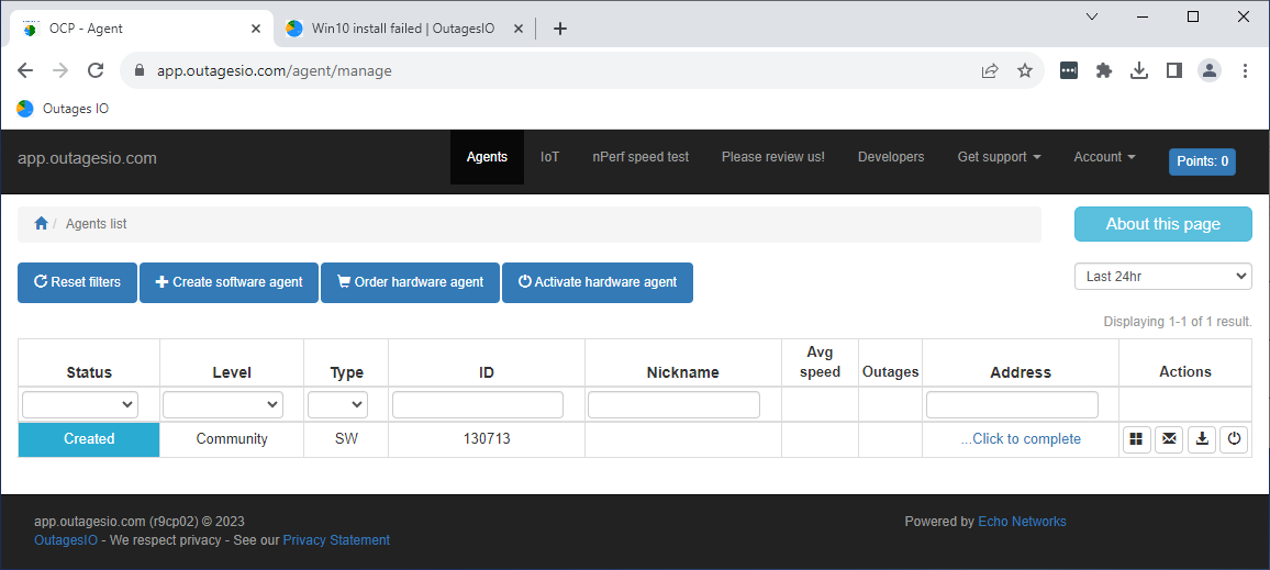

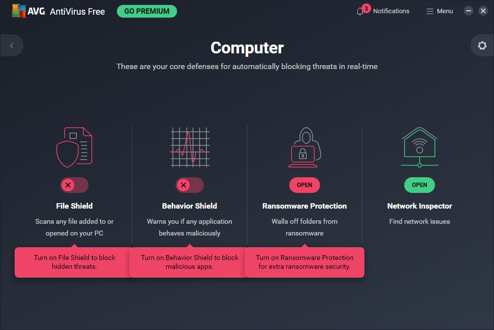

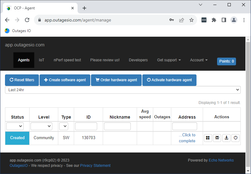

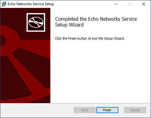

      Logged on as Admin. Created Agent 130703. Disabled anti-virus software. Installation appeared to "finish" OK. Agent seems to be running (see image below), but display still says installation needs to be completed.

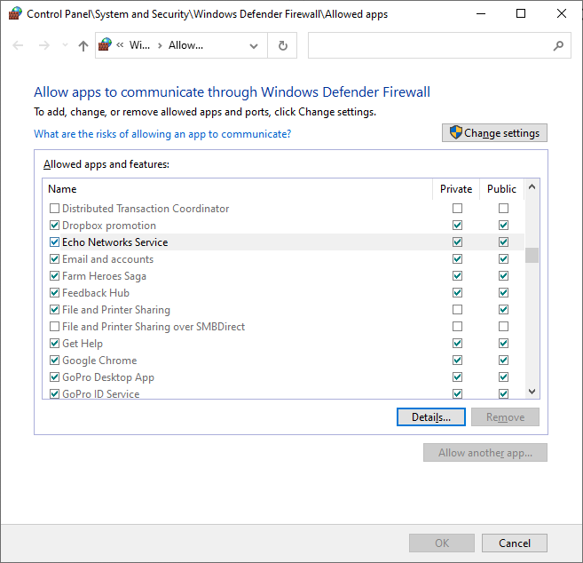

      Windows Defender firewall shows Echo Networks Service as being allowed through the firewall.

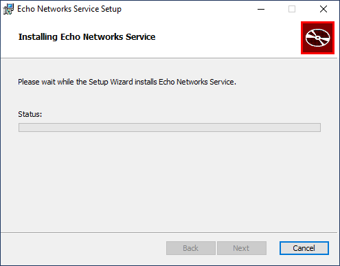

                ok, will do - and I'll take screen shots as I go
