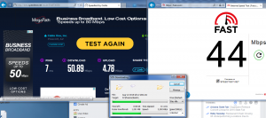

    First, we used a 50Mbps (6.25MBps download) Internet connection for the test. We started a file transfer of a 2.4GB file that we regularly back up and allowed the transfer to settle in, giving it a little while to get up to speed. We started averaging around the 2000KiB/s area which is about 16.4Mbps. Of a 50Mbps, that leaves around 33.6Mbps. The transfer did hit higher speeds at times, up to around 2700KiB/s.
    We need to point out that when a provider sells you a certain speed, that speed can and usually does range. Sometimes a little higher, sometimes a little lower and on average, that changes. So, we’ll just use the number we were sold on this connection which is 50Mbps.
    We started testing the speeds using both speedtest.net ™ and fast.com ™ and found their results fairly comparable but fast.com showing slower speeds than speedtest.net quite regularly. One such example is as follows. We tested over and over again and fast.com generally showed less speed than speedtest did.
    Of course, while testing, we were using up the bandwidth so it only makes sense that speeds would be lower on both sites if we tested at the same time. However, we tested only one at a time, waiting for the transfer speed to build up each time.

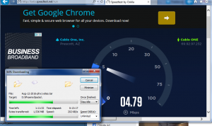

    The interesting part was that while both were showing a reasonable result, it was odd that our transfer speed ended up going as low as only 202KiB/s which is only around 206.8KB/s (kilobytes) or 1.65Mbps. Why is this very interesting?
    First, we are downloading from one of our own servers which has a 1000Mbps connection on the Internet. The server was pretty much idle at the time of the test and testing from the server to another showed over 900Mbps available to us. While transferring, the speeds never hit what we are supposed to be getting which is 50Mbps yet there was bandwidth left which the transfer should have been able to use. Where did the extra bandwidth go?
    Second, while testing, the transfer slowed down because we were using up the bandwidth of course. However, after we stopped testing but continued transferring the file, the 50Mbps connection was very slow, very sluggish, trying to pull up a web site on a very fast remote site that we often use was not fast, it was very slow to load the page, taking nearly 30 seconds.
    That is odd because we have a 50Mbps which was using only around 16.4Mbps while transferring the file. There was no other heavy traffic on the connection, at least not at our testing location. So, where is the rest of the bandwidth?

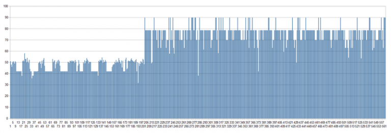

    The image graph above was one of the more interesting testing that we did. In this case, a 100Mbps service tested regularly around the 50Mbps range as average and the next week, started getting closer toward the 100Mbps speed sold by the Internet provider. This one stumped us because this is a massive difference in speeds. We will continue to monitor this service to see what happens.
