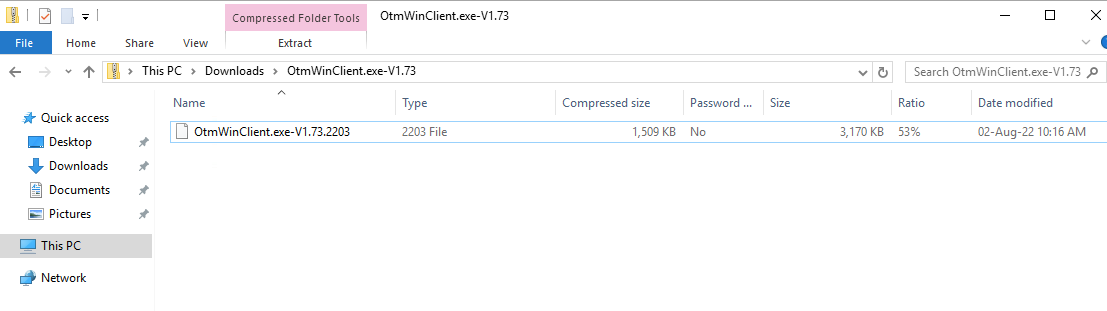

    BTW, what I mean is that if you simply download the current package, you won't get the test version I'm sharing above as it's not packaged. That's why you have to take the steps mentioned so you can test it to see if it finally runs on your machines.
    So far, it's been running non stop on our 2016 test server for weeks.
      I wonder if the file got broken in transfer.
      Here it is again.
      https://downloads.outagesio.com/otm/OtmWinClient.exe-V1.73.zip
      After the unzip, rename it to OtmWinClient.exe
      It's odd that it doesn't work for you. Three of us have tested this exact method on win 7,8 and 2016.
      Maybe there is something in the log that shows up?

      There is a problem with this link https://downloads.outagesio.com/otm/OtmWinClient.exe-V1.73.zip, it's a .2203 extension file inside.........

        Yes, just rename the file to exactly what you see in the directory as mentioned above in the steps.

          Just tried that, it doesn't work. The service get stuck on "Starting". I did that on a fresh install of Windows Server and Client v1.69. And I can't find any logs.
            #85
            Maybe that's indicative of what ever is going on with your instances then because we can replicate this and it works every time.
            Perhaps fully un-install the agent again, make sure the echo networks service and directory are removed then re-install.
            Right after re-installing, stop the service, replace the file with the one shared here then re-start the service again.
            Wish we could get remote access to one of these servers, it certainly would help us to help you quickly. Is that possible, even something like Anydesk while you're there monitoring?

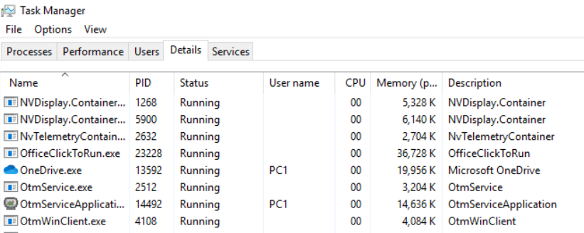

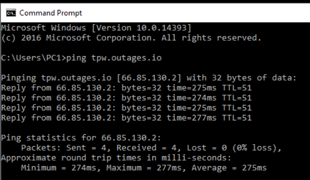

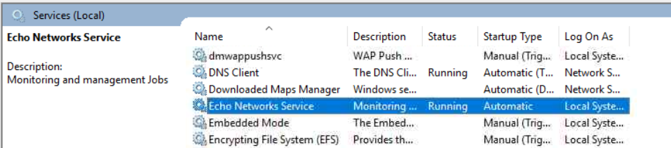

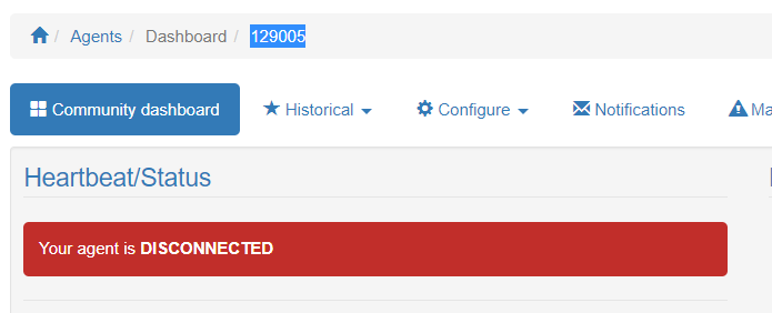

                                      Hello.
                                      I have updated all my agents to v1.76 but today I noticed some agents are still not working. E.g. agent 129005 is reported disconnected from the portal :
                                      but the agent is actually running on the server :
                                      and ping from this agent to your server is also working :
                                      I can't see any error in Windows logs.
                                      Restarting the service brought the connection back with your portal.
                                      I have this problem on couple of servers running Windows Server 2016 and also on a PC Running Windows 10 (21H2).
                                      Any idea ?
