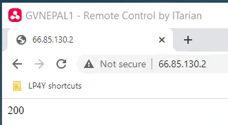

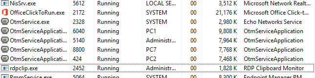

        @SBK Thank you for quick reply.
        For example agent 129004 is running on the host :

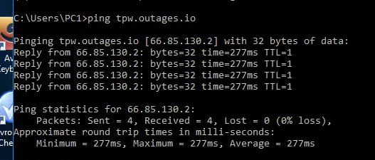

        and I can ping your servers :

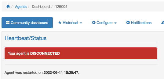

        But the agent is showing disconnected on the dashboard and there are no recent reports :
        I tried to restart the agent with no effect.

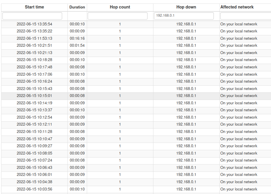

                  @lp4y

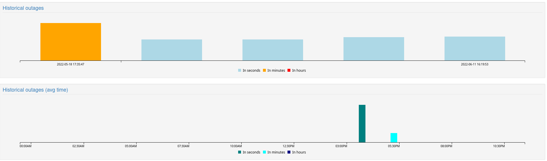

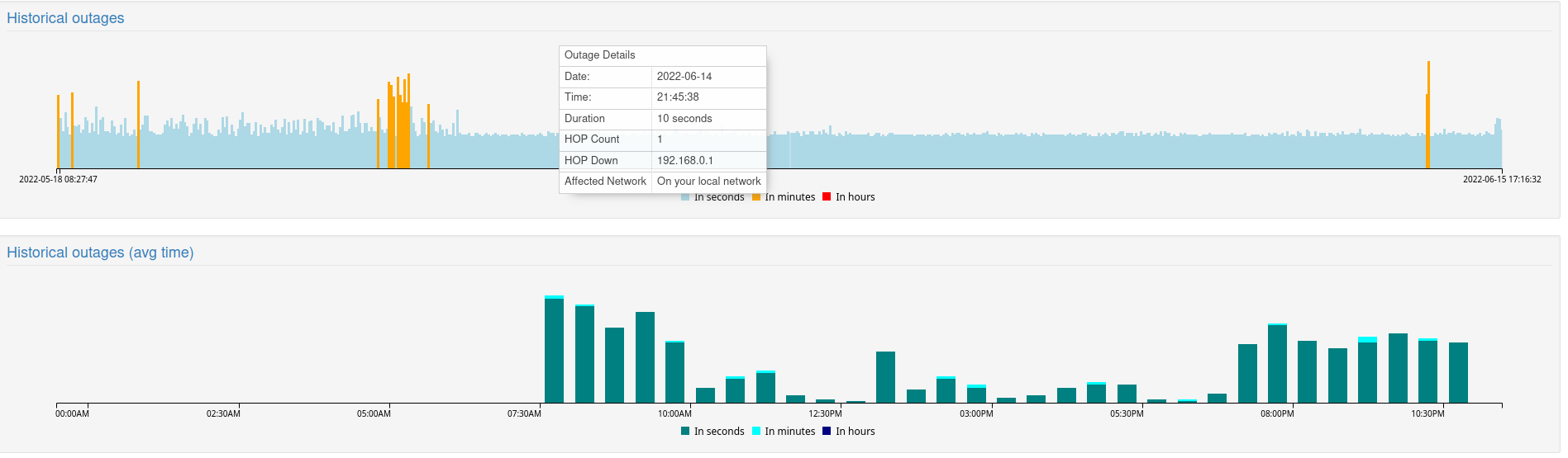

                  Agent 129004 is sending correctly pings while 129005 is not.
                  This means 129005 is not allowed to process ICMP otherwise that info would be recorded.
                  I also see that the agent is alive only for few hours meaning that either the PC is up only for few hours or the process running in Windows is stopped: usually that means the installation was not done using admin privileges which could be one possible issue
                  On agent 129004 I see this
                  and this

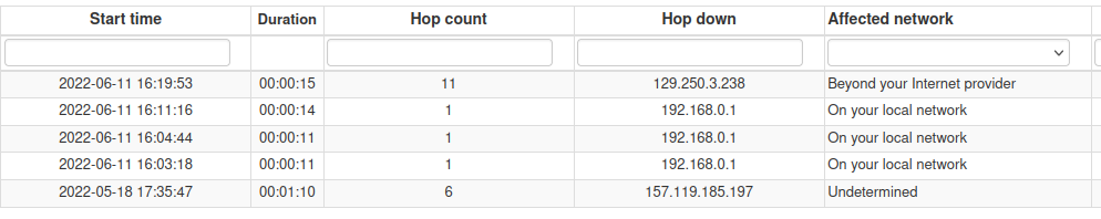

                  bit strange the outages on your router (192.168.0.1)are always around11 to 14 seconds (10 seconds of handover I still think of that)

                    @lp4y
                    and this

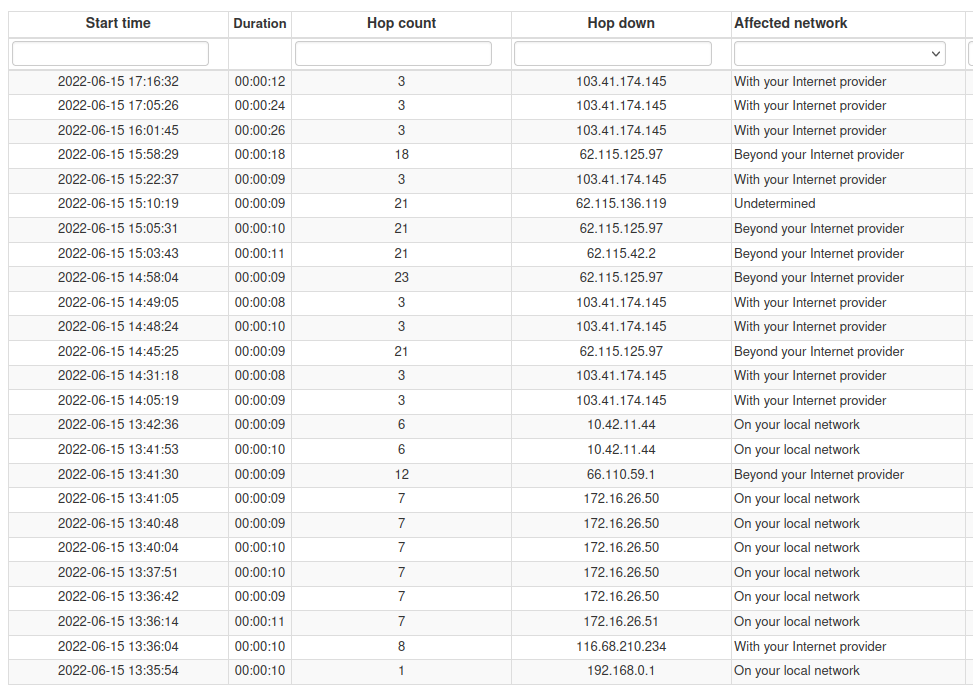

                    While 129005 I see this:
                    and this
                    and this too
                    quite consistent the downtime of around 10 seconds for your router

                      @SBK The consistent downtime for agent 129005 is because the router keeps trying to failback to the primary WAN access.
                      For agent 129004, I installed it with admin privileges and ICMP is allowed, I already provided you with a screenshot.

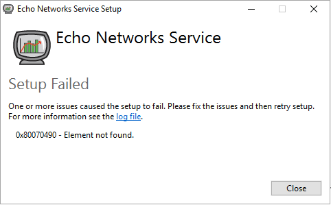

                        @SBK I had this problem on agent 129013 too. The agent was reported disconnected from the portal but was actually running on the server. I tried to stop it from services.msc and then start it again and it solved the problem.
                        This is not a communication issue between the agent and your servers but most likely a bug on the agent.

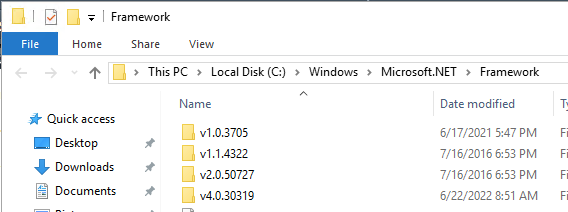

                                All of our servers are running under Windows Server 2016. Some of them don't seem to have a problem with the agent.
                                Is it possible to check the logs somewhere ?
                                  I am checking into this but I seem to recall that old operating systems like this can no longer be supported because MS doesn't maintain some of the .NET stuff that the agent needs to run correctly.
                                  That or check if the servers where the agents are not working right are fully updated or not. That could be another reason.

                                          Since you are having to use that version, maybe we can find an older version of the agent that would function on your servers but with that would come some missing functionality that we've added over the years.
                                          Depending on how critical your needs are, our hardware agent is inexpensive, runs 24/7, is self updating so you'll never have any of these issues and it will never miss a thing.
                                          All of the above said, I'll get together with SBK tomorrow, the other person helping you and see if there is anything obvious we can spot.
