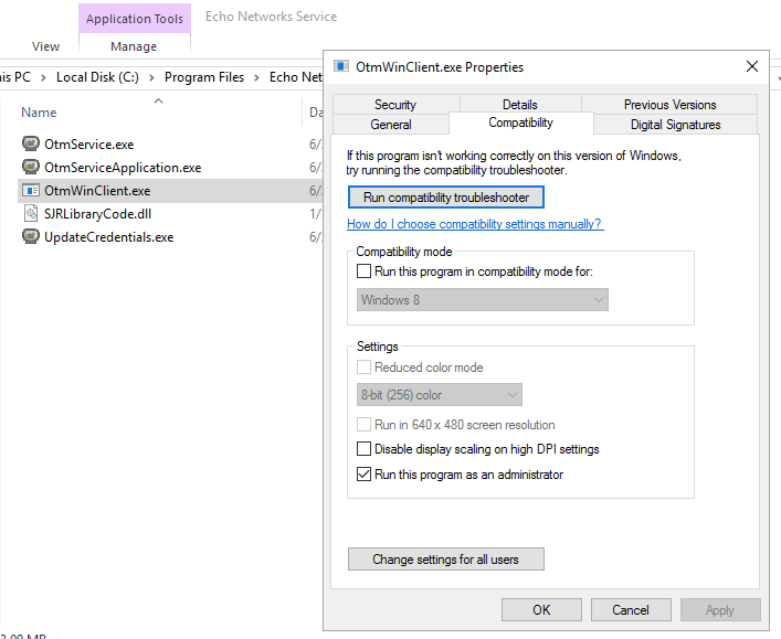

    I have enabled to run OtmWinClient.exe as Administrator on agent 128994 :
    I'll let you know if I see the agent stopping and being restarted.

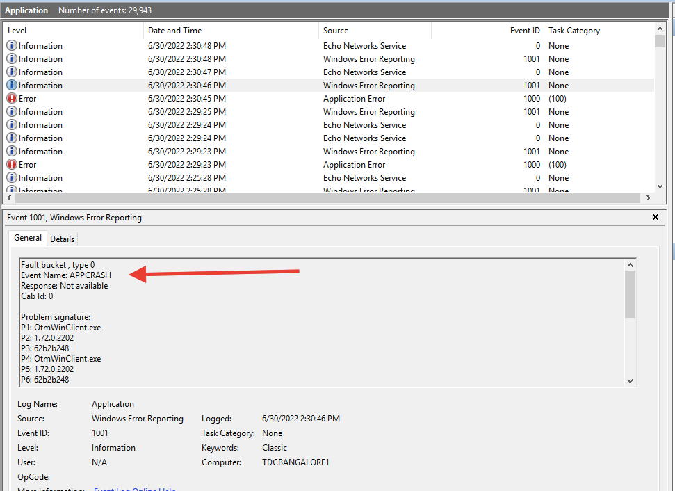

    I didn't solve the problem, the agent stopped 5 times today :

        I think the app is crashing, see from the event viewer :
