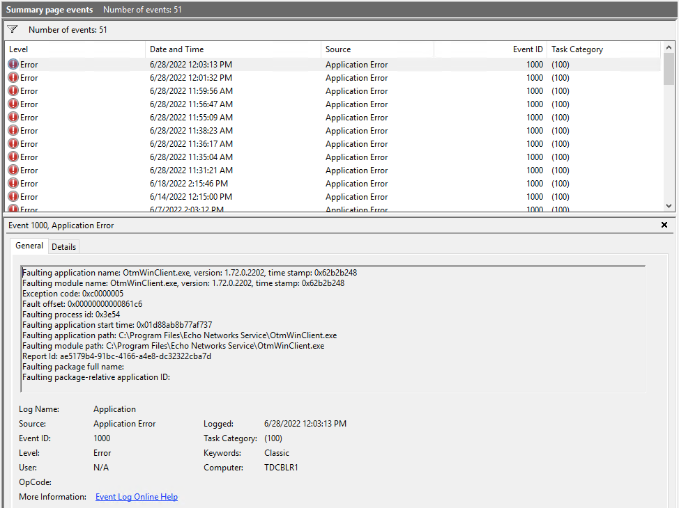

                      lp4y
                      wrote on last edited by lp4y
                      #50
                      Just found some errors in the Windows Event viewer (all the errors are from OtmWinClient.exe) :
                        #51
                        That's great, thanks. Any more logs or information you might see that can be shared?

                          #52
                          Why don't you change the apps to admin in the properties box (compatibility tab \ run as administrator) and see if that helps.
                          L 2 Replies Last reply
                            #53
                            Only the top-most entry is shown. So it would be interesting to see if the others have the same “fault offset”
                              #54
                              Can you let me know which version specifically please.
                              Standard or standard with desktop or dc or dc with desktop?
                              L 1 Reply Last reply

                                      #58
                                      @OutagesIO_Support said in Agents is running but not reporting:
                                      Not from the event viewer I guess. Is there any application logs somewhere ?
                                        #59
                                        To be transparent, we're not trying random things, we're actually working on this in the lab.
                                        So far, we are able to find some small things we can improve on but have not been able to replicate this. On our 2016 test, it's working non stop, the service does not get turned off. Therefore, we need you to try things on your server that we don't have access to in order to get some feedback otherwise, it's hard to help.
                                        Right now, we could use more logs from your server so the agent developer can have some leads.
                                        We really want to see this working for you. We think it's important because we aren't really supporting servers and maybe we should.
                                        Most Enterprise customers use hardware agents because they don't have to deal with any of this. They install the agent, power it up, it's done. The agent self updates when and as needed and we can even troubleshoot them from remote.
                                        We have to keep in mind that every server out there is different from others. Even if your are all the same to each other, they are not the same as other win2016 servers. Combinations of settings, software installed, countless things make every server unique.
                                        Anyhow, we appreciate your patience and if you are willing to continue, we are working on it in the background.

                                          I have enabled to run OtmWinClient.exe as Administrator on agent 128994 :
                                          I'll let you know if I see the agent stopping and being restarted.
