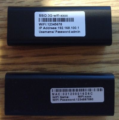

      At one point, we were testing these little $8.00 3G/4G mini routers which were working very well.
      However, finding the real hardware became impossible as Chinese clones started flooding the market.
      Now they are worthless. You'll notice on eaby and other places that Chinese sellers never show the rear label and when you ask about it, they pretty much always say they don't understand the question.
