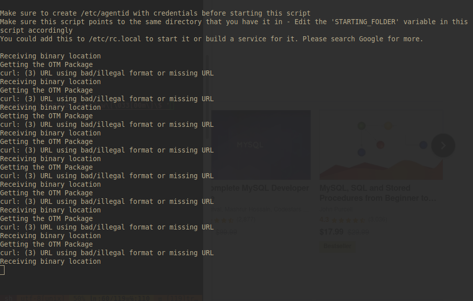

            It first complained a log file was not present. I created the file "otminfo.log" manually, an ran the script again. It is stuck in a loop repeating this error message:
            "Receiving binary location
            Getting the OTM Package
            curl: (3) URL using bad/illegal format or missing URL
            curl: (3) URL using bad/illegal format or missing URL"
            Here's a screenshot, maybe it will help:
            And here's what the script is printing:
            Let me know what you discover!
            Thanks,
            cwa

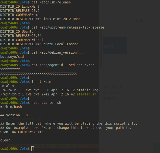

              Oh yeah, a couple more things. I can browse to the URL shown in the script and can log in successfully with my credentials.
              Also, I can verify the script is reading my credentials from /etc/angentid correctly (I used "echo...." in the script).
              cwa

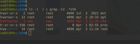

                      I thought of the same strategy last night, and I assure you that /otm has 777 octal permissions; I checked a few times just for my own sanity, and here is a screen shot:

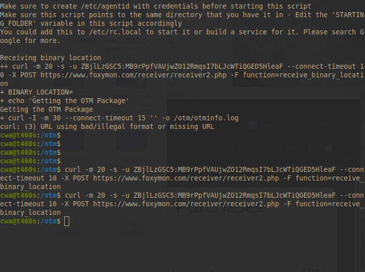

                      As for capturing the output of the curl command, I did exactly as you suggested, and their is no output, and no error either. I thought perhaps some quoting my help so on lines 38 and 39 I inserted the set -e and set -x commands. set -x prints out all of the commands executed in the script along with values assigned to variables. set -e stops execution at the 1st error thrown. We can see exactly what is going on line-by-line as the script executes. Here is a copy of that part of the script with my edit:
                      until [[ ${OTM_HTTP_STATUS} -eq 200 && ! -z ${OTM_REMOTE_LENGTH} ]]
                      do
                          sleep 5
                          echo "Receiving binary location"
                      set -e
                      set -x
                          BINARY_LOCATION=$(curl -m 20 -s -u $USERNAME:$PASSWORD --connect-timeout 10 -X POST https://www.foxymon.com/receiver/receiver2.php -F function=receive_binary_location)
                          echo "Getting the OTM Package"
                          curl -I -m 30 --connect-timeout 15 "$BINARY_LOCATION" -o $STARTING_FOLDER/otminfo.log
                          OTM_HTTP_STATUS=$(cat $STARTING_FOLDER/otminfo.log | awk '/HTTP/ {print $2}')
                          OTM_REMOTE_LENGTH=$( cat $STARTING_FOLDER/otminfo.log | awk '/content-length/ {print $2}' | sed -e 's/[\r\n]//g' )
                      done
                      And here is screen shot of the execution:
                      And as you can see, I copied the curl command an ran it a few times directly on a command line... it just runs silently. The second curl command throws an error since the variable $BINARY_LOCATION is empty, and the script stops on that error.

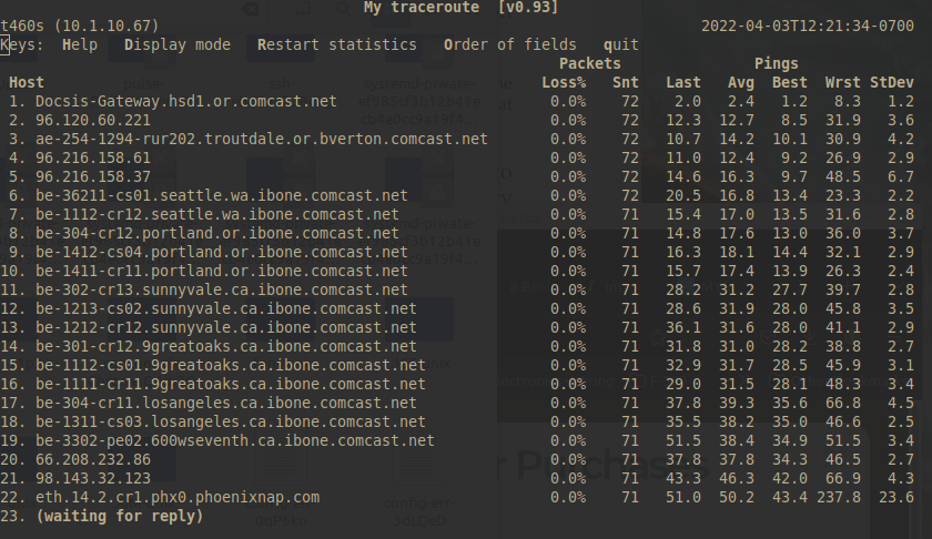

                      It turns out it is a network issue and I don't no how to deal with it. I hope you guys do. I did this:
                      Packet transmission is always stopped by the same host eth.14.2.cr2.phx0.phoenixnap.com. Since no packets ever reach www.foxymon.com, the 1st curl command has no output since $BINARY_LOCATION is empty.
                      Any ideas?

                        Any ideas?

                          BTW, pings will fail once they get into the data center. We block ICMP at the firewall due to heavy scanning of our network.
                          C 1 Reply Last reply
                            @cwa
                            Just to confirm, you still are experiencing the same issue?
                            C
                            C
                            cwa
                            @SBK ,
                            Yes, no change. I was hoping you guys would have found out what is going on. I'm a database admin, so I'm not very strong when it comes to troubleshooting network issues of this kind. If there are any other tests I can do let me know.
                            ~ cwa
                              C
                              C
                              cwa
                              @OutagesIO_Support ,
                              I am willing to run any kinds of tests you guys suggest. I'd really like to use your service. I spent a ton of time searching for a service like this and yours seemed to be the best for my needs.
                              ~ cwa
                                We're not going anywhere so it's important for us to fix anything that prevents anyone from using the service.
                                About the only problems we have left to find a solution to is a loss of access between the application and the database.
                                We're completely aware of that one and have been working on it for days trying to find the root cause. So far, nothing obvious, just lots of empty leads.
                                There are no other reasons that the site would be unreachable unless something on the Internet itself is causing our site to be broken somehow.
                                I don't know of any DNS hijack or anything along those lines since we didn't change DNS for the service, only for the DDNS function.
                                Maybe it's something that will just go away and start working suddenly. Really not sure what to say since we see everything up and running and have a ton of outside monitoring so we know about problems.
                                This is not an excuse since we know it's affecting more than one person but simply don't know what could be causing it.
                                How could you help? I don't know. I have to review the entire thread again and see if we can come up with some ideas.
                                Do you have another PC/Server you could try from, at another location perhaps?

                                  @cwa
                                  Please try to execute this command on any console you have:
                                  curl -m 20 -s -u ZBjlLzGSC5:MB9rPpfVAUjwZO12RmqsI7bLJcWTiQGED5HleaF3 --connect-timeout 10 -X POST https://www.foxymon.com/receiver/receiver2.php -F function=receive_binary_location
                                  and let me know if you get an answer with a URL or still nothing as an answer
                                    I just tested and the above works for me. The download link is shown.
                                      @cwa
                                      C
                                      C
                                      cwa
                                      @SBK
                                      It runs successfully:
                                      https://downloads.outagesio.com/otm/otm_1.67.2104_linux
                                      I created a new agent and it worked with no issues, so I'm good to go now.
                                      ~cwa
