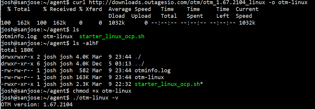

The first thing is to download the agent on it's own, without using the script, make it executable then start it then run the above command to confirm it is running and only one is.

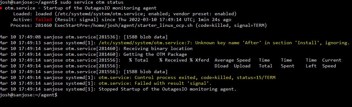

sudo service otm status

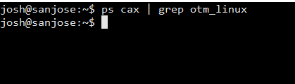

If I search for the running process with your script I get nothing.
ps cax | grep otm_linux

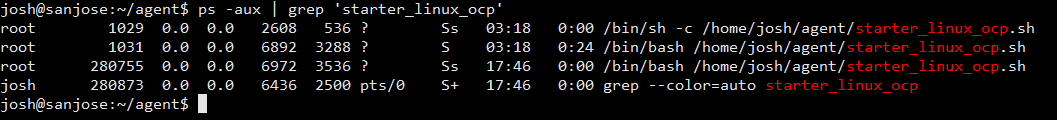

If I search for the name of the script I do get some results, so I manually have killed all processes running the script,
ps -aux | grep 'starter_linux_ocp'

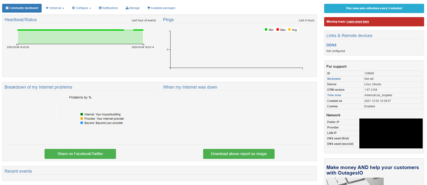

- Agent shows as "Inactive"

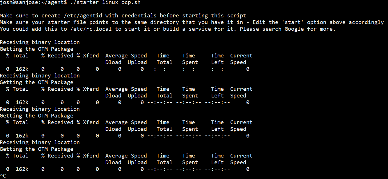

- Edited the script to run manually.
# exec $start/otm_linux & $start/otm_linux &- Run the script manually and I'm right back at the beginning where it won't download the file. There are no apparent errors with credentials, permission to download the file, or anything indicating why it can't download the file.
