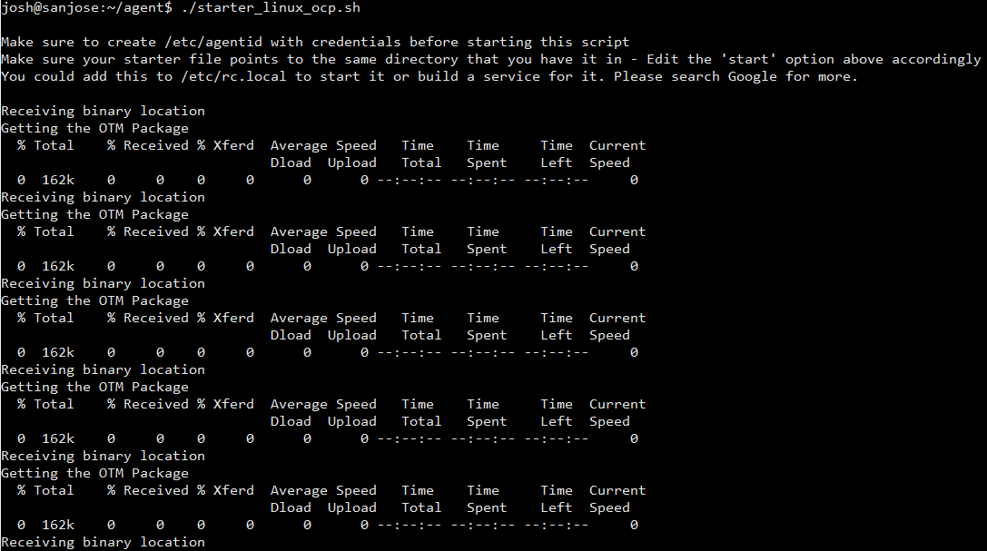

                        @OutagesIO_Support This is installed on an Ubuntu server, so I am using the linux script. The reason I posted here is I am seeing the exact same issue where it keeps trying to download the otm_linux binary and can never successfully do it. I can repost to the Linux section if required. I was just thinking the symptoms are identical, so the solution might be the same.
                        I have also tried to disable the service, adjust the script as below, and then run in manually (screenshot). I get the same result where it loops trying to download the file.
                        Script when service is enabled:
                        ## exec $start/otm_linux &
                        #$start/otm_linux &
                        Script when service is disabled and the script is run manually:
                        $start/otm_linux &
                        Here is my service file. Located at: /etc/systemd/system/otm.service

                        Results when running the script directly.
                          #32
                          Yes, it doesn't seem to be finding the binary. Can you try this manually.
                          Go into the same directory and run both;
                          curl http://downloads.outagesio.com/otm/otm_1.67.2104_linux -o otm-linux
                          See if that downloaded the binary. Delete it and try https.
                          curl https://downloads.outagesio.com/otm/otm_1.67.2104_linux -o otm-linux
                          If it's there, make it executable then run the version.
                          $ chmod +x otm-linux
                          $ ./otm-linux -v
                          Show me the output please.

                                      • Nothing is being populated in the ping field or recent events.
                                      • The public IP is not updated to the correct address.
                                      • The service on the Ubuntu machine shows it is running, but I cannot tell if it was able to download the agent or not. Manually downloading might have helped this get started.
                                        #39
                                        Wait now, one thing at a time. We need to be in sync.
                                        You said that you were not able to run the agent at all, that it kept downloading but that's all.
                                        The script shows you can use this to see if the agent is running.
                                        ps cax | grep otm_linux
                                        Can you check so we can see if there are one or more instances running.
                                        Since we see it running, kill it so we have a starting point.
                                        The first thing is to download the agent on it's own, without using the script, make it executable then start it then run the above command to confirm it is running and only one is.
                                        If you see it running, then kill the process and we'll do this next.
                                        Next, try this.
                                        curl -m 20 -s -u xxxx:xxxxxxxxxxxxxxxxxx --connect-timeout 10 -X POST https://www.foxymon.com/receiver/receiver2.php -F function=receive_binary_location
                                        The above is from the script. You replace the xxxx:xxxxxxxxxxxxxxxxxx with the credentials you have /etc/agent. Note the semicolon.
                                        What this does is to query your account for the new agent you've created so it can give you the latest version of the agent for that particular OS. Show me the output of this please.
                                        We'll deal with the rest one thing at a time to prevent confusing each other.
                                        P 1 Reply Last reply
                                          Next, try this.
                                          P Offline
                                          P Offline
                                          PJPorch
                                          #40
                                          Sorry...I guess I was jumping ahead when you said you showed the agent as active.
                                          I have stopped the service from running.
                                          sudo service otm status
                                          If I search for the running process with your script I get nothing.
                                          If I search for the name of the script I do get some results, so I manually have killed all processes running the script,
                                          ps -aux | grep 'starter_linux_ocp'
                                          When I run the curl command with my credentials I get a response of
                                          "https://downloads.outagesio.com/otm/otm_1.67.2104_linux" which looks like it exactly matches the URL I was able to manually download from, so that part of the script seems to be working correctly.
