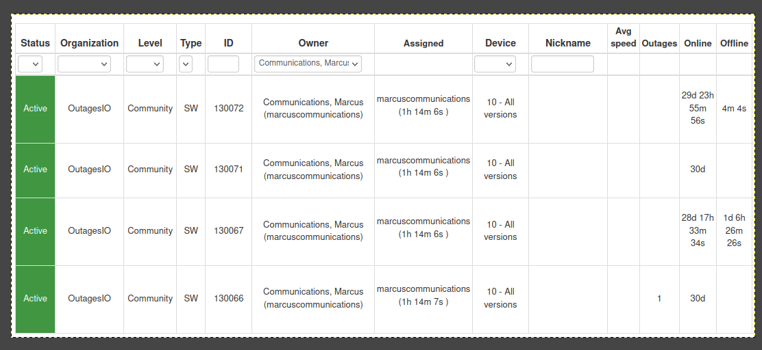

          @marcuscommunications
          This is what I see...
          In the last 30 days the only one having a full 1 day+ offline period was the 130067
          Both 130071 and 130066 were ok and 130072 shows a 4m and 4s offline (could be a reboot or some minor disconnections, normal with today's internet)
          This makes me think that we should investigate a bit more on what is really happening to the 130067.
          Is it possible that the installation was done WITHOUT admin rights?
          If so can you please reinstall the agent (there is a procedure to do it)?
          If it is not an admin rights can you compare the windows versions, patch level or specific filtering (at the PC/server level) or at the router level (since they are in different physical locations) ?
          Let's start with this and please let me know.

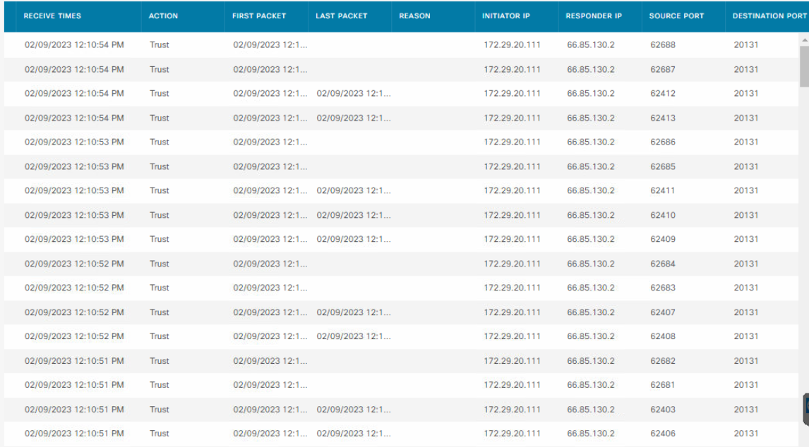

              This is what I see on our firewall for traffic coming from the agent and going out to what I assume is the Outages IO reporting server.
                    @marcuscommunications Yes, that's one of the servers it would be communicating with.
                    Does the service show running on the PC that the agent is running on? And if so, can you still ping the above IP? The other won't respond.
